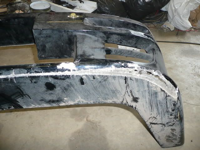

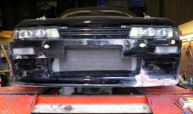

No1- The front bumper was as good a place as any, as it took some damage at the last event. Stu kindly helped out filling the holes and getting it back into 1 piece, before I did anything with nasty fiberglass resin and finished it off.
Some of the damage before:
Back together:

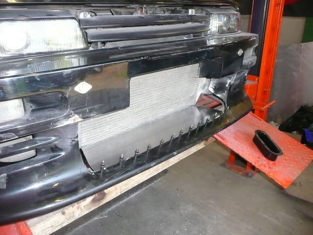

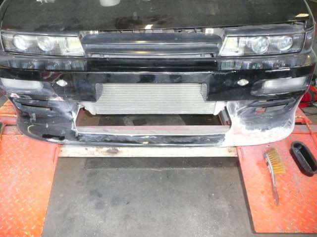

Then i decided the car could have better aero and cooling so cut a really big chunk out of my expensive body kit:
I have now started filling it with a fabricated aluminium wing section that ducts into the intercooler. Before a big chunk of the intercooler and radiator were covered up rather than fed air. I even straightened lots of bend intercooler fins whilst doing it. Not quite finished yet, but part way done:
I have made one of the end pieces with is the complex part of the fabrication, but forgot to take a picture. I will hopefully post a pic of the completed duct soon anyway

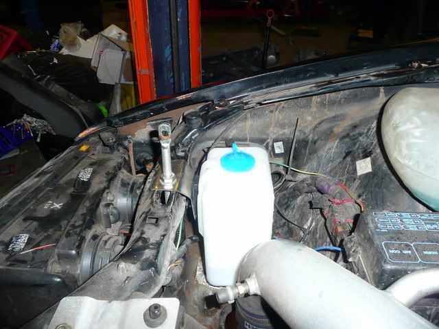

No3 - I also fitted a real washer bottle finally, to replace the "1 use only JDM coke can" that came with the car. Didn't take long at all but did need pulling out, modifying and refitting after I got it in and it only managed to dribble like a old man. After some investigation it turns out the part came with a 0.5mm hole to feed the pump, but once that was drilled out and refitted it worked much better and I only needed to make a bracket to mount the new bottle. A scrap of metal and 15minutes later I had it all in and working for good. (surprising how often you need this on some drift tracks)
Back together:
