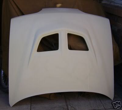

To cheer ourselves up and give ourselves a bit to do, we have bought something which we have been looking into doing for sometime.
good wright up mate but were is the mock up that i made for the new bonnet that is worth putting up for a larf :-D
Alan's mock up of how it might look when fitted.

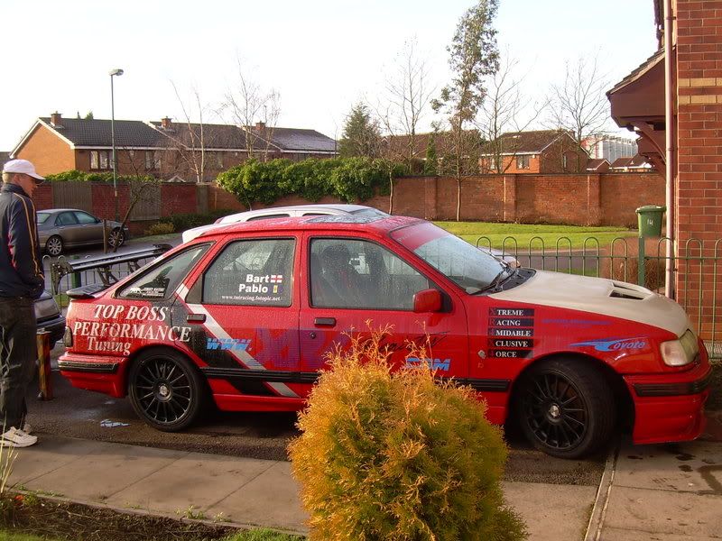

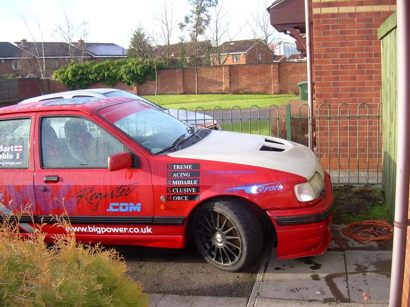

Christmas pressie for the car

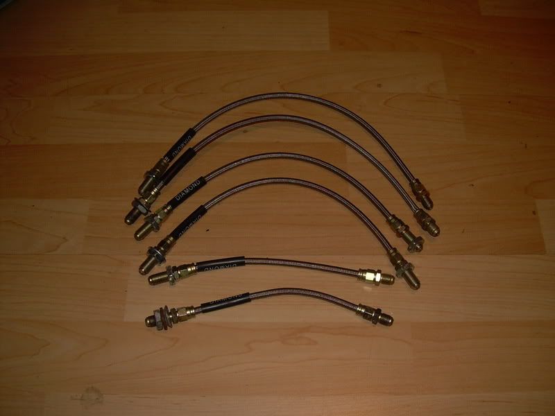

Picked up a couple of things for the car yesterday. An early start and a trip ahead of us, decent driving weather and getting bits for the car. This is what the weekend is about :grin: We left at 7 in the morning for our trip down to Wiltshire in Al's GT. With no radio (He has lost the facia in his flat :roll: ) Basically we spent most of the drive talking about the track car and the year in general. We were having such a laugh that we completrly missed our junction :roll:

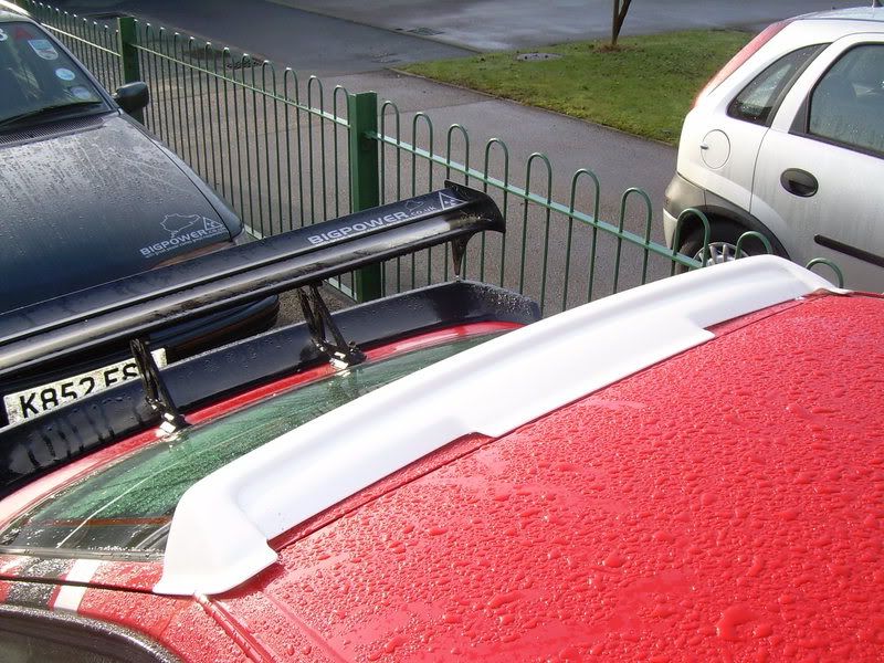

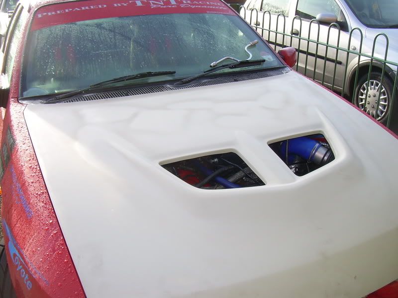

The intention was to collect some braided brake hoses and the new bonnet...However we managed to come back also with a cossie bonnet and 2 headlights and a roof spoiler. We had taken down some roofracks with which to attached the bonnet to. Imagine our surprise when we managed to get everything inside the car :o :o
I'm sure the bonnet will be good news in terms if heat dissipation. I'll be interested to see what results you get after testing.
We're planning to take both bonnets and both bumpers to Bedford in February to carry out back to back testing of all parts :grin:
