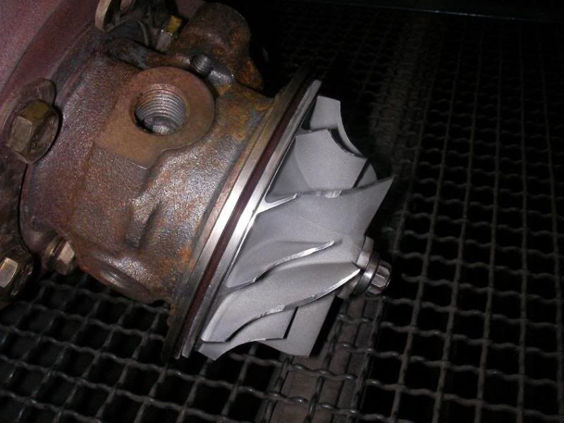

was performing we heard the scratching from the front of the car we had
a look and bliped the throatal and it turns out the turbo was F####D

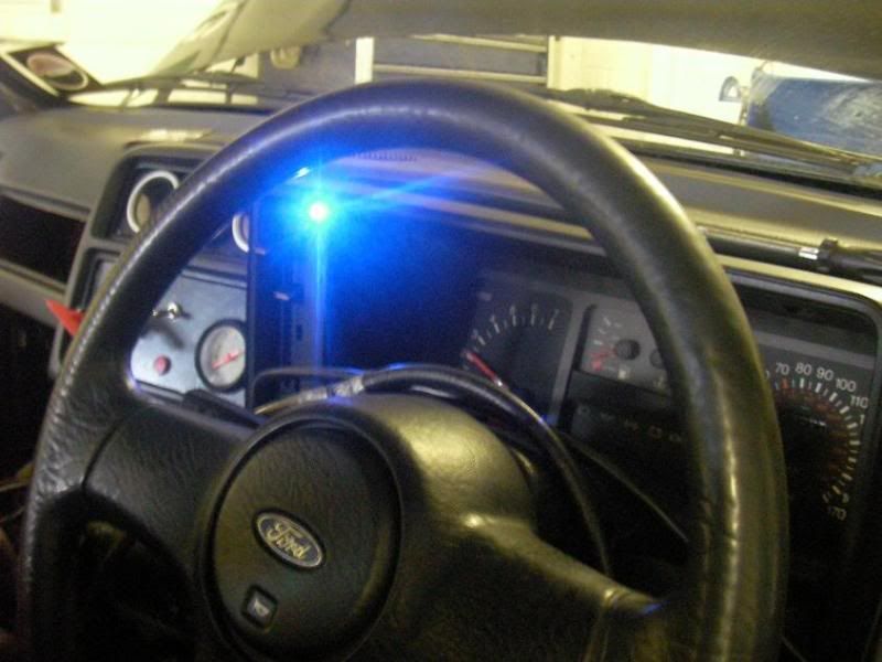

only good thring from today was that i have fitted a shift light that is going to come on (once ECU fixed) 500rpm before the
bhp starts to tailer off to keep at peak performance.

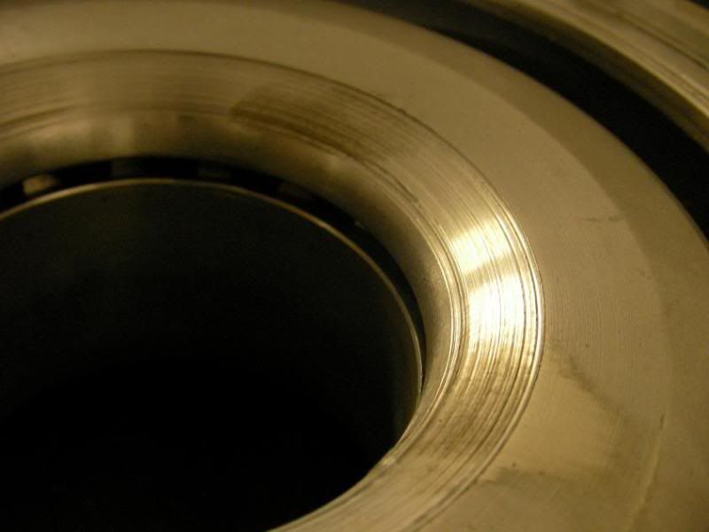

this is the old turbo and can see where its been catcching on the housing

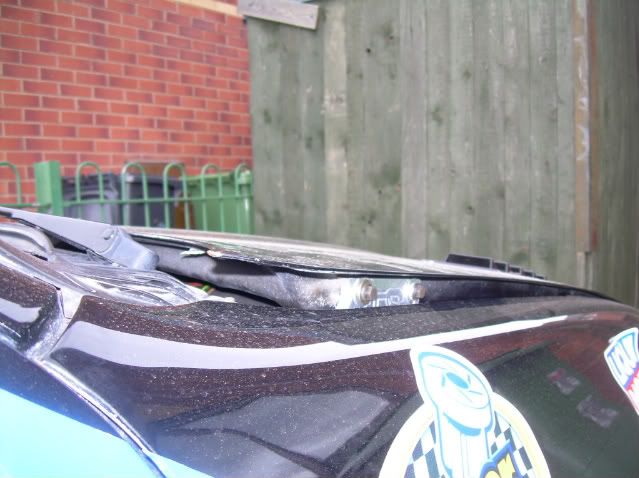

9. Sunroof blew out

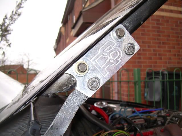

10. Bonnet raisers to be fitted - Not running hot just a precaution
