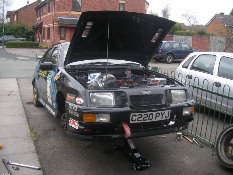

done a bit of work to the car today ready for bedford but not got to much done as it started to rain

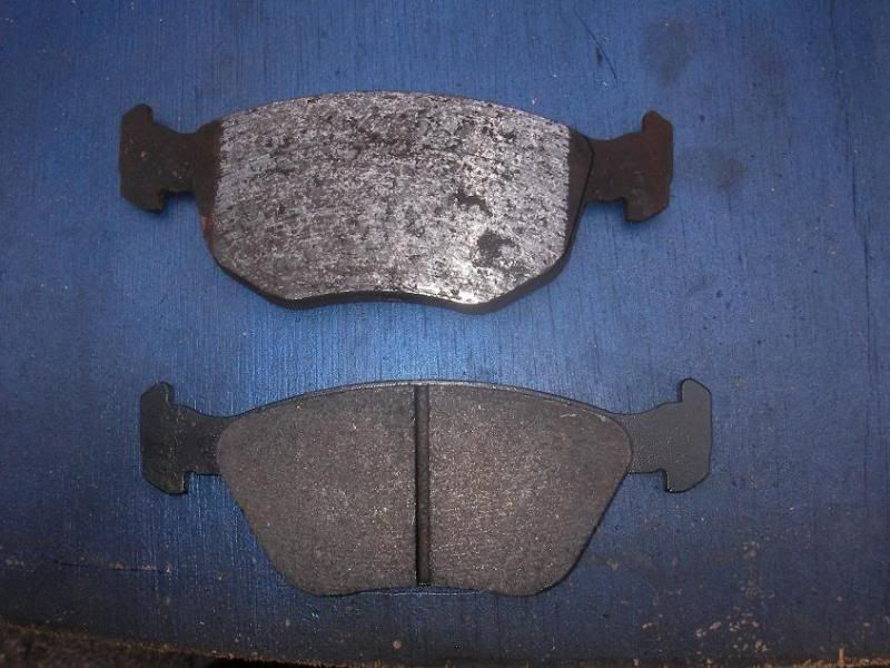

changed the front brake pads for mintex racing pads, the old ones when
we took them off looked like they were at the point of cracking in some
places and were smooth as hell.

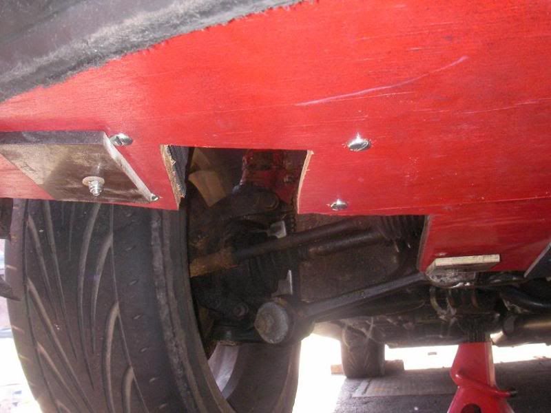

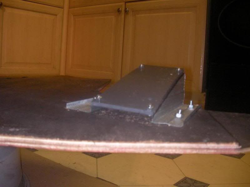

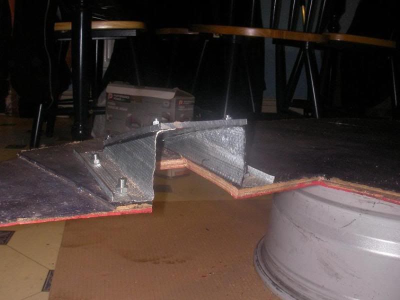

while i was doing the brakes and a oil change on the car paul worked on
the spare undertray we have, using the one that was allready on the car
used it as a template he cut it to the same size.
them fitted some brake ducts to direct air upto the brakes for cooling.
we didnt manage to fit it to the car due to it raining.

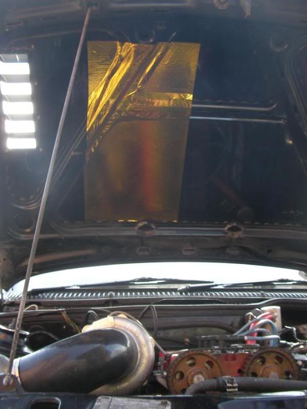

we were also going to fit this but again rain stopped us.

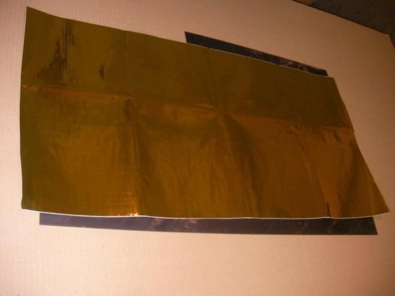

it gold heat barrier sheeting to go onto the bonnet as the turbo sits
so close to it we dont want paint coming off lol
Nice to see you guys got the heat shielding sorted out so quickly (Very mcLaren F1 ;) )

fitted the undertray to the car and made up some new mounting brackets
for it. think these ducts will help get a air flow to the brakes.

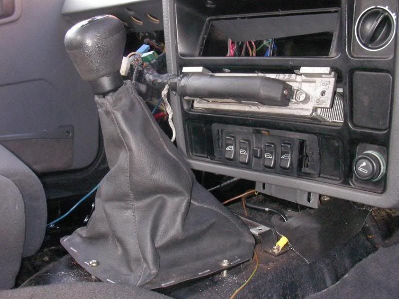

set about sorting out the wiring loom and ECU as it was just sitting in
the passinger footwell, thankfully it fit like a glove in were the old original
ford amplifier unit sat. i also fitted the lether gaiter.

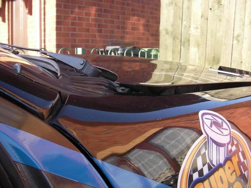

fitted the gold heat shielding to the underside of the bonnet amd also
raised it to allow more air to get out from under the bonnet.

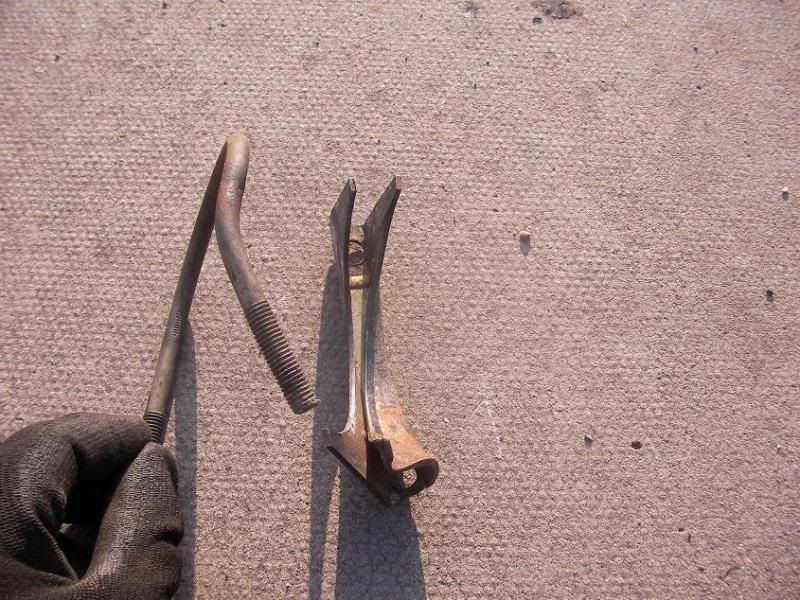

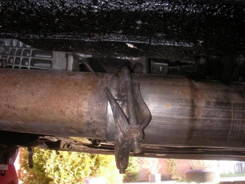

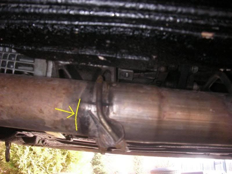

while under the car i noticed that something was not quite right with
the exhaust, a closer inspection shows that Mr Stapes drive way has
given our car a war wound :smilielol5:the yellow lines is where exhaust should be.
tryed to get bracket as straight as possable and ill get a new one next week

Stepped bonnets are the way forwards :) I accept no responsibility for the drive.........I bet you didn't fill the holes back in :)
