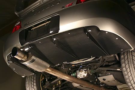

Are those pictures nabbed from us Dunk? ]http://i78.photobucket.com/albums/j95/T ... 820519.jpg[/img]

now THAT I LIKE !!Trojansport wrote:frayz wrote:Like the front splitter mate.. everything else is worthy of the skip IMO.. Spend you money on performance, she's a stunning car that i think would be ruined with all that bolt on chargespeed shite.
Function is where its at, if it looks pretty too then thats a bonus![]()
gimme gimme
Nick .. What is that? - i cant find it on your site

We do tons of stuff that's not on the site mate. We only show about 5% of stuff on there as it takes a few minutes to put on every item!
The beasty in question is an APR Performance Rear Diffuser. You can't really beat APR if you want aerodynamic parts.
