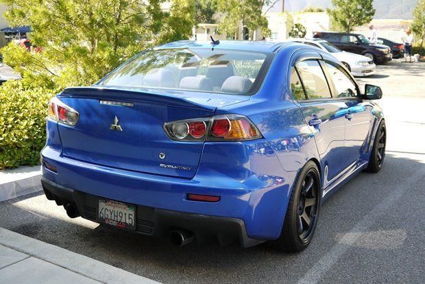

You'd need 18's in the cheaper wheels or a set of 17inch TE37's .. the TE37 has a square inner profile so a smaller size will fit over the bigger brakes.
A good size wheel (double check with images) - 18 x 10.5 + 15 5x114.3
Example of the dish on an Evo
