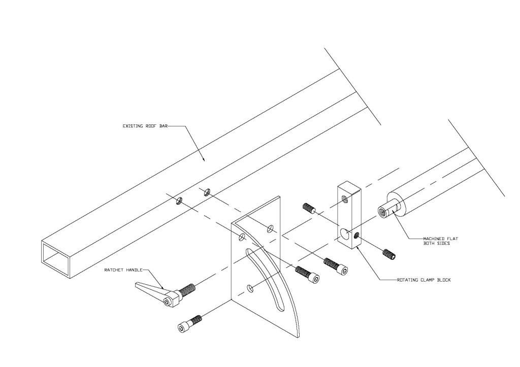

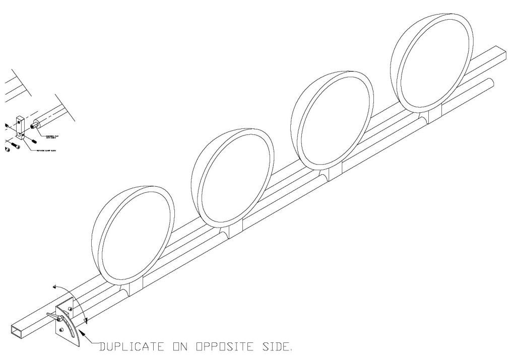

Okay so now I have to plan ahead for the imminent collection of the spot lamps from Tony (cheers mate :smash:) Reason to plan ahead is the issue of fitting spot lamps to the roof bar. Normally just bolting it on and away we go would be the best option.
But since the Pajero's garaged every night and with restricted height, it's going to cause problems. Solution. A long drop bracket bar. :)
This will enable me to lower and raise the whole spot lamp bar from the side of the truck with ease for when ever I need the extra light. And convenience of parkng it away every night without clouting the lamps on the garage door. :) Once I've drawn everything up it'll be fabrication time. :smash:
