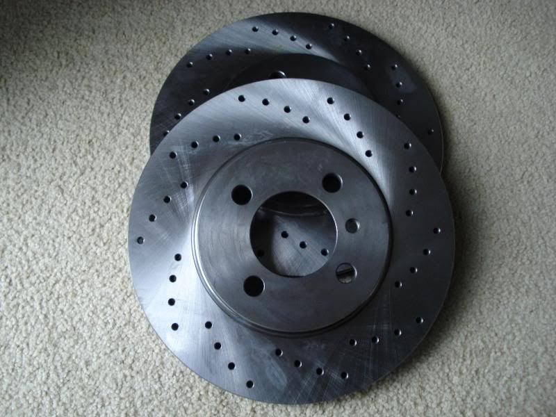

New discs ordered from GSF (Zimmermann X drilled)

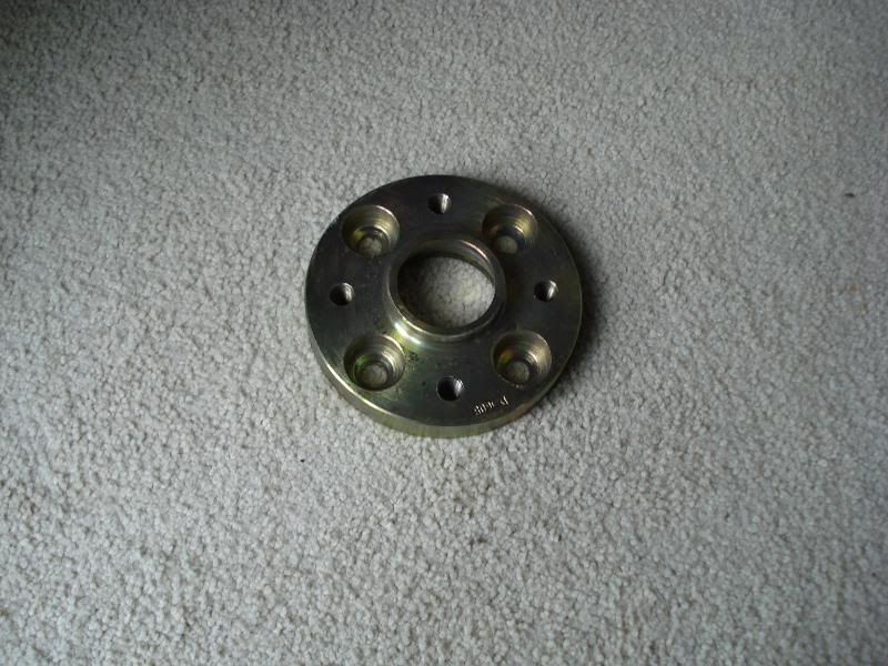

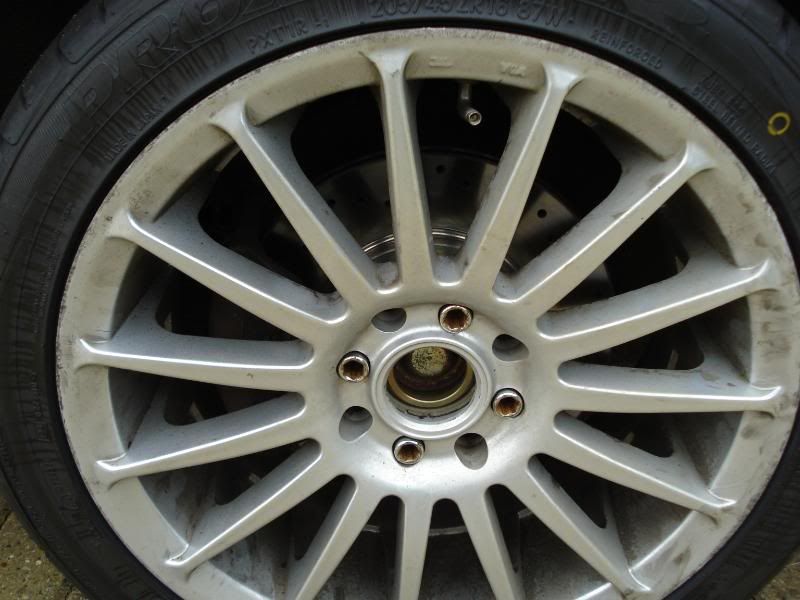

Some 20mm wheel spacers to fit my 16" wheels and some wider tyres
Got 4 New Toyo T1-R tyres (205/45/16) being fitted Mon morning

New tyres are now on :-D What a differance the old girl accually wants to go round corners now :-D

New Zimmermann X drilled Discs and Yellowstuff Pads Fitted. 8)
Just got to Flush out the old brake fluid and fill with Race brake fluid.

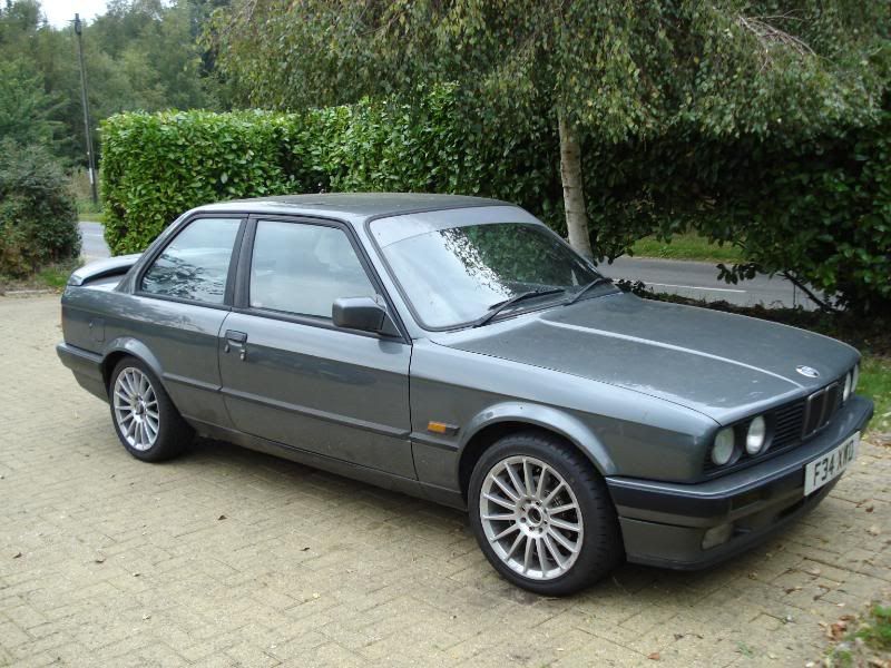

How the Car is Looking now
