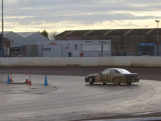

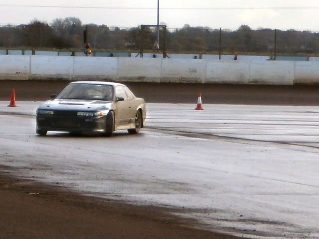

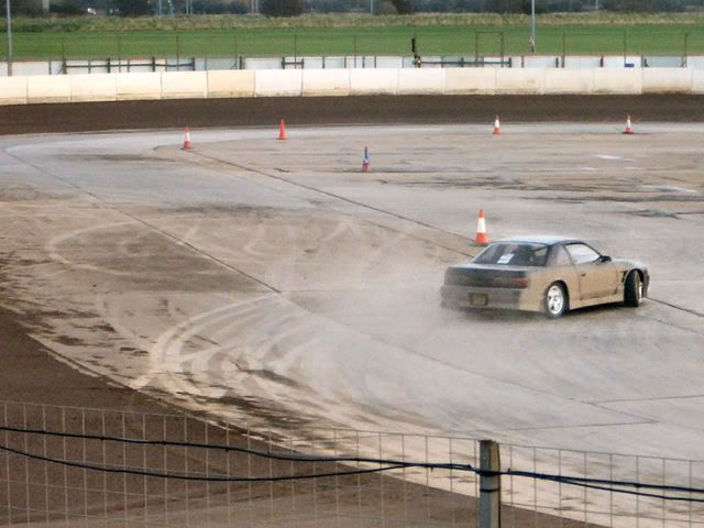

Well, that was all the struggles, but last weekend I put it on a Hunter to give it a decent setup and the next day I drove the car full of tyres, tools and a helpful pitgirl to Norfolk Arena for my first chance to try the car in anger. I wish I had taken more photos but I was distracted by the driving and constant tyre changing required. Luckily Pit Girl Liz filled in for me and got some good videos and a few images of the day.
