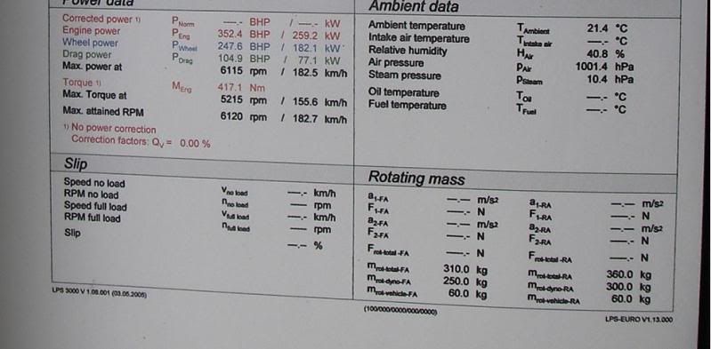

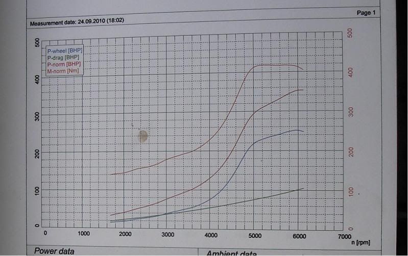

here is a power graph from when the car was working for a short time it did
Well if that can be repeated and hold together long enough to punt around a track, which obviously it can, you guy are going to have so much fun :D
