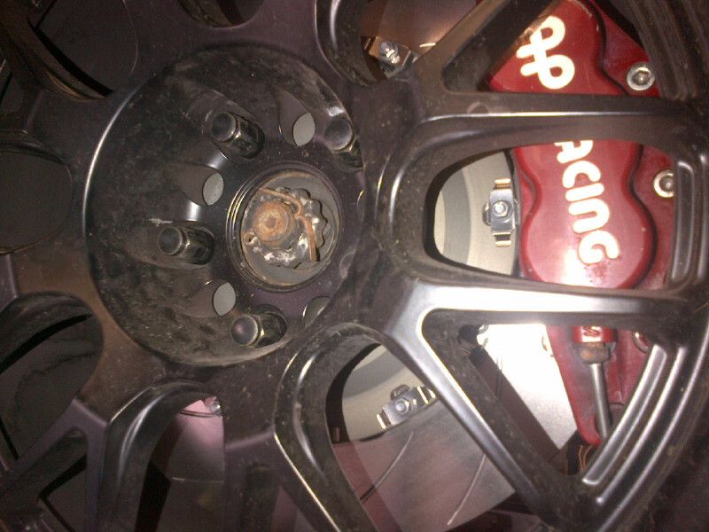

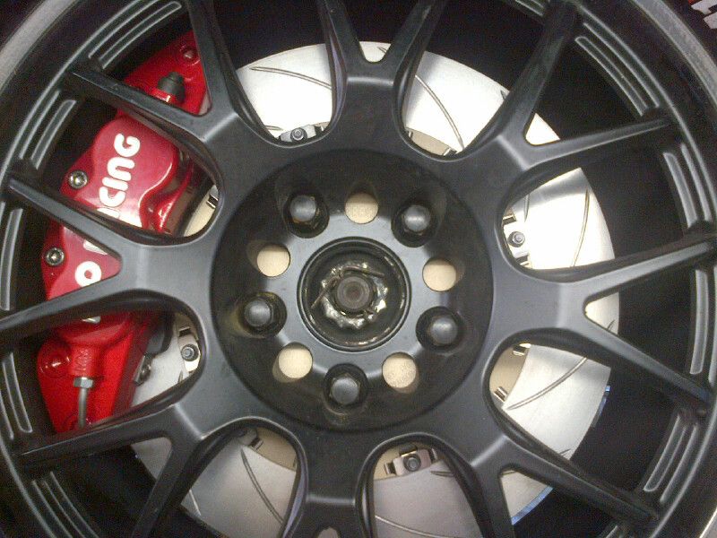

I now have a new custom made front brake set up. I'm still using the same model AP 6 pot calipers but with the heavy duty thick brake plate type discs with 72 cooling vanes (my old discs which are the stock AP offering for R32-R34 were much thinner material and 48 Vane). The new discs are basically the ones used on the R35 kit through to the 458 Challenge cars so should offer much better heat resistance and dissipation than the old ones. AP themselves say these are the best they have (for my application of course). These were custom made as they dont make this type of disc in the "diminutive" 356mm size to fit my car.
AP also custom made new "floating" mounting set up, again using the R35 (and others) floating bobbin style mounts and custom bells to fit the R32. This, says AP, is the best set up for track in terms of dealing with heat and kerb impacts, while the floating bobbin means you don't get the potential stickiness associated with a full floating system.
So I'm over the moon to have had all this made for free and can't wait to try them out. Sorry for rubbish pics but a blackberry/me combo doesn't a good picture make

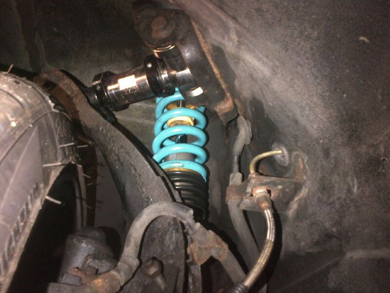

I also have a crap photo of the new 1000lb Nitron springs in their now trademark turquiose despite me ordering "snow" colour, which confusingly is Nitron talk for black!!?
Anyway, annoyingly as mentioned before these are likely to mean another wheel allignment, although Daz pointed out that actually, once the allignment gear is attached, if the fronts are out then it's just a case of windign the spring platforms up or down, rather than full adjustment, so hopefully thats will be cheaper and easier as I only had it done 2 months ago. I dont however want to chew up the MPSCs if it's out

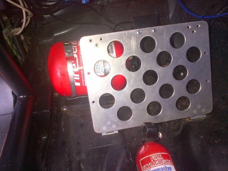

few more bits. Finally took a pic of the fire Ext which is mounted nicely behind the footplace in the pax side. Currently have both nozzles in the engine bay, one on the turbans and one on the fuel rail. Once we get round to doing the bracket may try and rig one up inside.

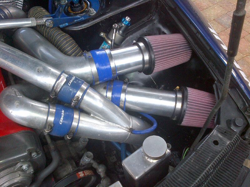

Also decided that after several years the Nismo filters could do with a change. I know they're supposed to be cleanable etc but my experience of this has never been very succesful so decided to bin them and put some K&Ns on the car. Another benefit of this was trying to get them further away from the heat as I was able to chose size/shape etc. So settled on these puppies and some pipe extensions to the Greddy intake kit. Can't imagine it'll make much difference but they're a servicable item so why not... an the Nismo's were slowly wearing their way through the bonnet too...
