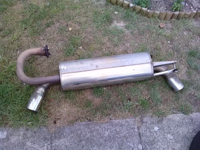

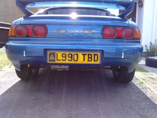

So again today, made shit loads of progress :)
Surprisingly got the exhaust of within 5 minutes;

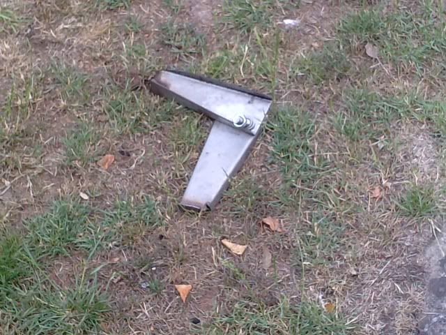

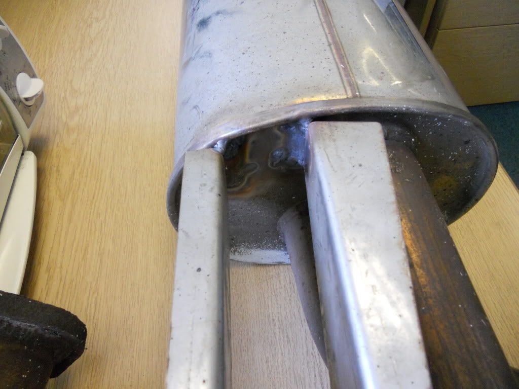

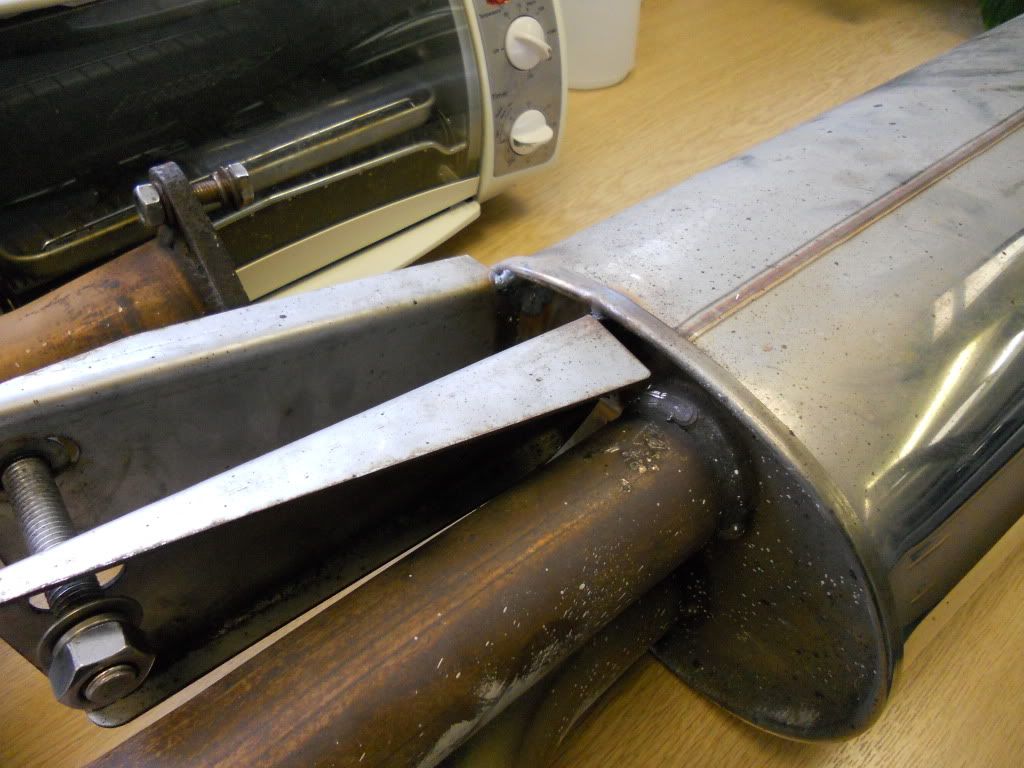

the broken bracket; (sounds like a pub name)

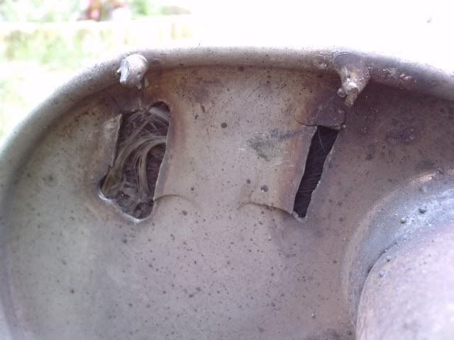

Oops, thats not good.
So monday that'll all be taken care of with some half decent welds instead of their weak ones. :)

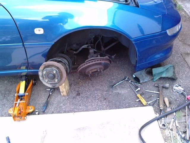

Then it was time to take care of the 'fractured' drop link bracket, which actually was totally busted off by the time i drove it home. excuse lack of photos at this point, but i had the whole lot off;
Surprisingly i can remove and refit the strut without needing a spring compressor. :lurk5: so the broken part was removed from the drop link, then dad re welded onto the bracket and then i put everything back together again. Also the number plate bulb was replaced and is now working again.

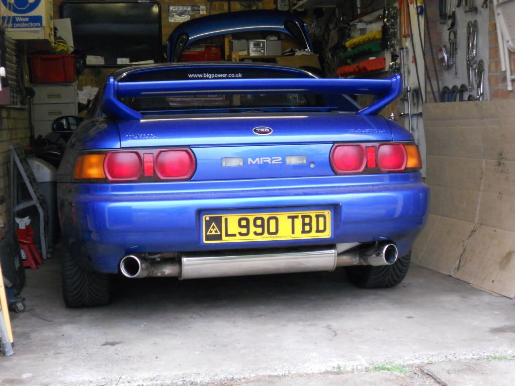

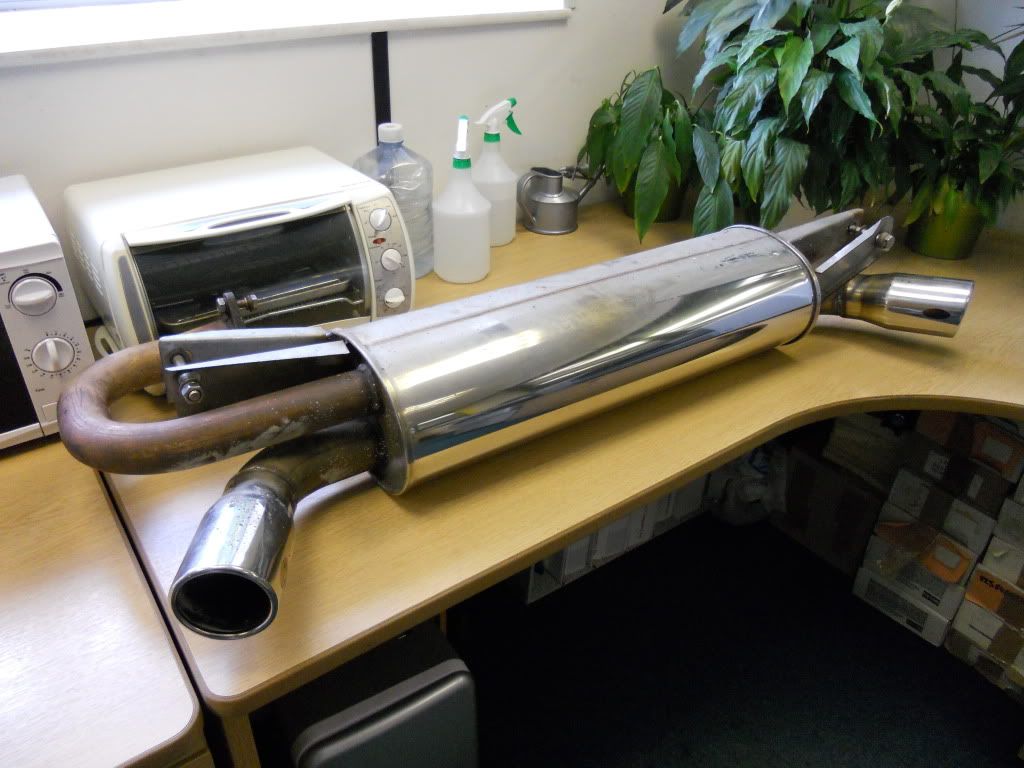

This morning i had to go over to Griston engineering to discuss materials i'll be using for an assembly i'm designing for work, so an oppertune moment to have the exhaust fixed. And i can safely say that the exhuast has been mended :smash:
That saves potentially 2 weeks of dicking around having it replaced under the lifetime warrenty. So 'if' it ever breaks again after the MOT certificate being issued then i will have it totally replaced, but for now the quick fix was the answer :)
Update: the MOT retest has been booked in for 1pm tomorrow :D can't wait.
Edit: exhaust now refitted and leveled up :D
