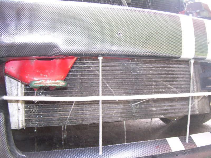

i have been working on a water injection system to cool the air going into the engine
i have managed to use the origenal water pipes for the head light wash wipes
and hucked this up to a alloy pipe that i have put pin holes into
im hoping that when the car is moving the water will spray out instead
of just a jet as per the picture.
this system will be more affective on hotter days that the car is used.

a water mist would be much more effective than those direct jets i think. The water way mist at speed though.
