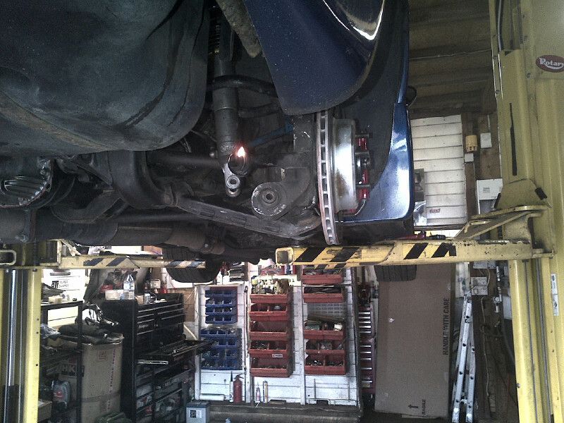

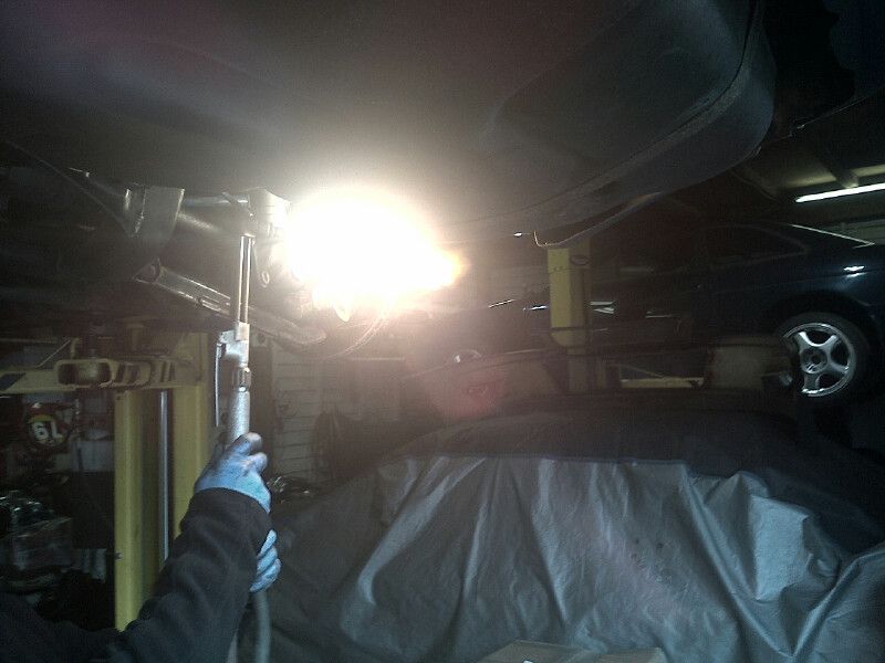

Ron at RK suggested heating the old Ball joints up and then bashing them out which turned out to be a good suggestion, popped out a treat
Also amusing as they burned, this pics not great but the other side was proper flaming up, couldn't grab my phone in time...
