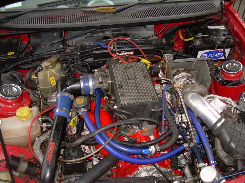

right since i was on here this morning i been hard at work.
after collecting the parts the heads, block and inlet manifold have all been
cleaned up and been fitted back on and the hole engine is back together :-D
ive just got to wait till tomorow now to fire her up as some of the
gasket sealent takes time to set.
parts i had to collect this morning

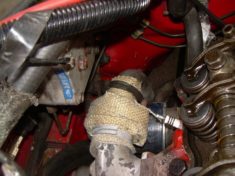

after taking the manifolds off some exhaust paste went into the cross over pipe
so out came pablo's vaccume to suck it all out
heads and inlet manifold all back on and tappets all set.
after pablo had a chat with gary from APT he recomended that we torque the heads
up to the max, cheers mate :thumb:
i have put gerrys idea of wrapping the one manifold joint with exhaust wrap
and under that there is exhaust paste to seal any leaks that may happen
wahoo engine all back together

It really should be Alan who is putting this up but he has to rush off....After a lot of problems with the timimng / dizzy the battery went flat :roll: Quick thinking he linked 2 sets of jump leads together so that he could jump start it from my Frontera which was parked behind it. Finally herbie spluttered into life :-D . The car was left running for about 30 mintues and everything seems ok. Just got to take it out for a little drive later and then tomorrow morning it's off to the dyno centre to be checked over and set up ready for saturady.....fingers crossed.
