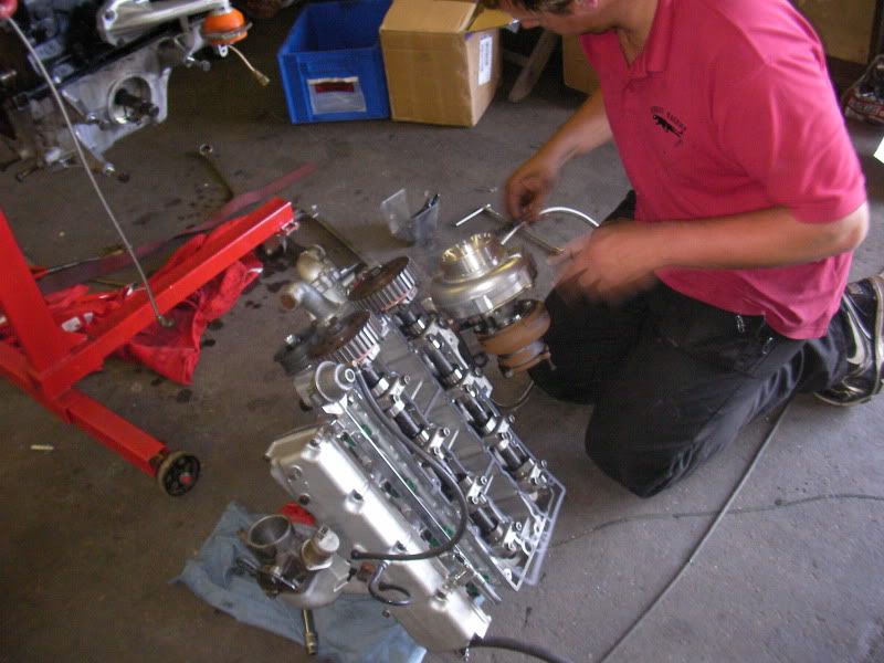

while gordon was fitting the crank and pistons i worked around him doing other things.

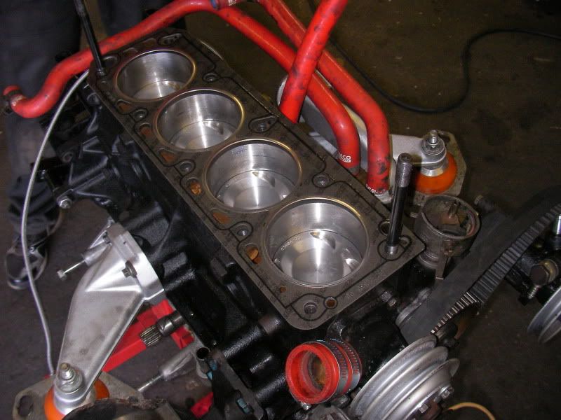

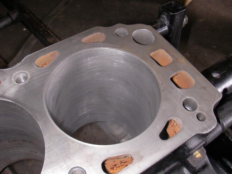

block back with sleeve fitted

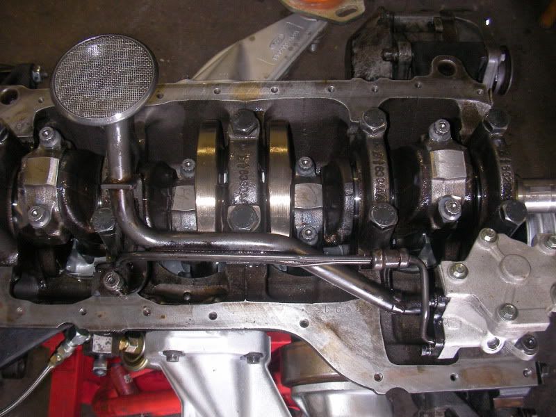

crank and pistons in, oil pump fitted

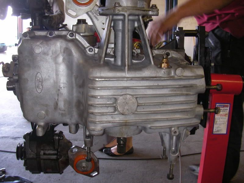

sump back on

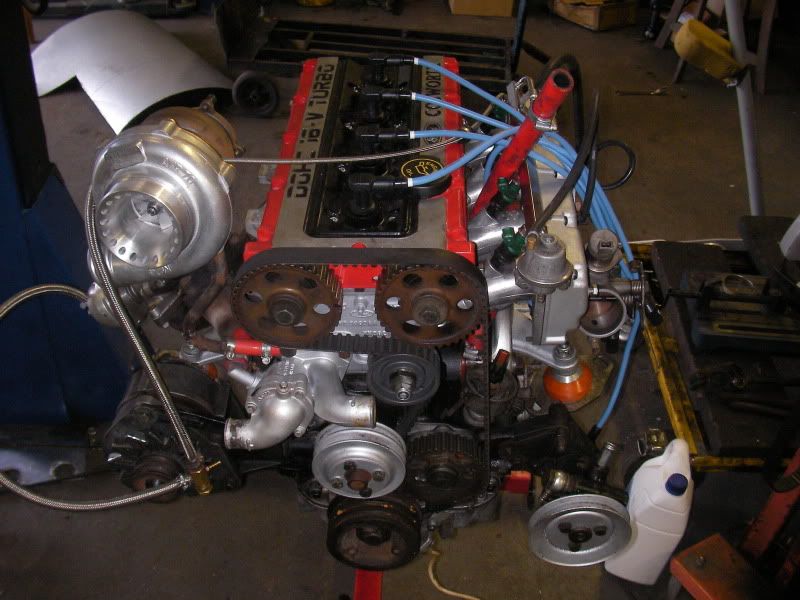

head on all torquered down and pully all fitted an together with cam belt
after 6 hours work this is the stage we are at now
shouldnt be to long hopefully till its back in the car, still loads to do
i forgot to put up and pablo has reminded me that the block to have to sleeve and rehonned cost
