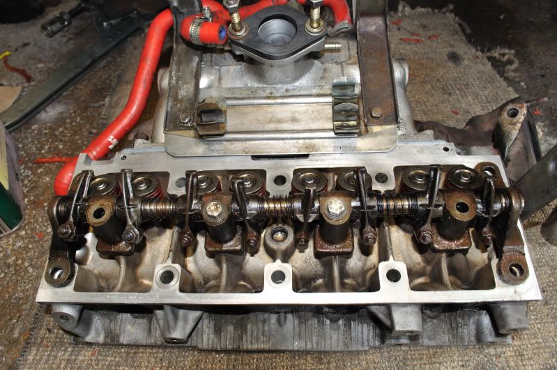

Head is pretty much built up only little bits left to put back on

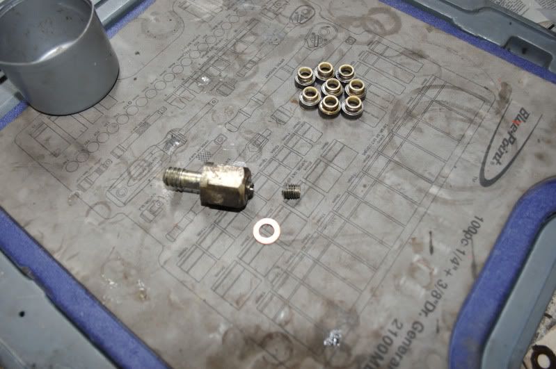

I broke a one way valve on the inlet manifold :(
Took it out to check it works fine and change the copper washer, put it back in and tried tightening it and it wouldnt tighten it just snapped :x
So i need to go over my cousins to get one off his 6 spare inlet manifolds he's got
