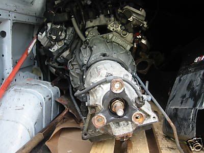

what about this as a donor - probably could be bought for a lot cheaper than its advertised
You'd probably get most the money back in breaking the rest

for quite a while the BMW V8s where on the ebay shopping list ( and even the V12 form the 850/ 750) Good manual gearboxs are not too easy to find, but are nice Getrag 5 or 6 speed units when you do. I also have access remaping the later 4.4s to some rather big power increases.
The problem is the ratios. Now I am running a Nissan rear end I need something I can get a suitable diff for. The most sensible thing is to run the Nissan diff and driveshafts, so I only need a custom prop. The nissan is 4.1:1, but the BMWs run a 2.8:1 so the gear ratios would be a real mess. The opels are 3.8:1 so a Nissan diff will bring them just that little bit closer together and suits the tall ratios the Omegas ran quite nicely.
And there is no way that this car is going to get an Auto box!

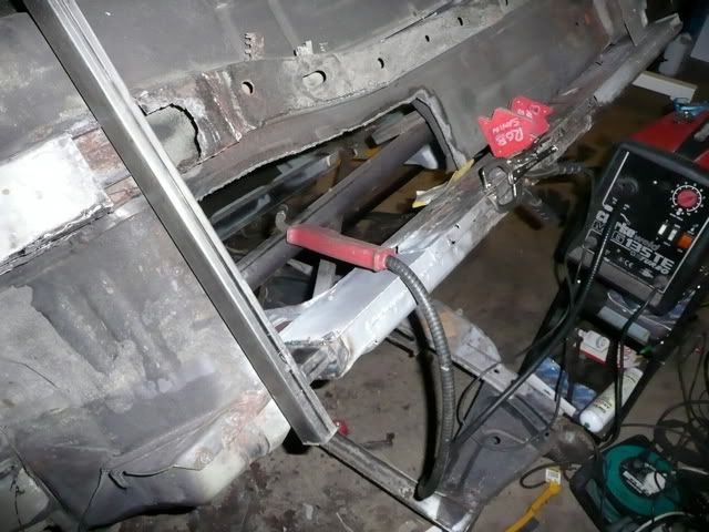

Did a little more this weekend. Mainly cutting out the last of the mangled volvo bits, more of the rusty nissan bits that appear, and then making the new custom bit with some decent strength steel.

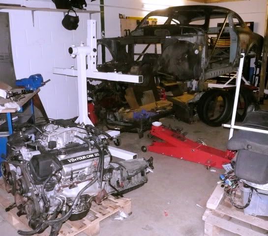

And then tonight i got carried away and made a risky Ebay purchase:

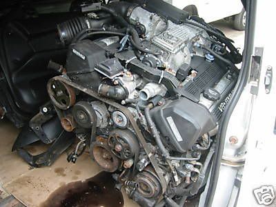

Yes - that is a Lexus 1uz-fe with a nasty auto box on the back, but will be replaced with a real gearbox before long. If I can sell some of the unused parts I have then hopefully a tremec tko600. That should deal with the torque from a couple of turbos. It should be a lot of fun, kind of like my silvia, with double the engine and a more central weight balance. I may have to look at brakes and how to deal with fuel prices next :roll: ...off to research LPG systems in race cars.

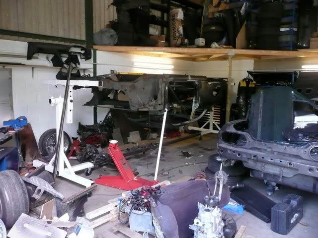

however this is about as close as it is getting to the car for a little while until the shell is further on:

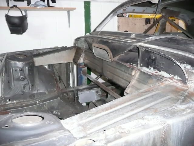

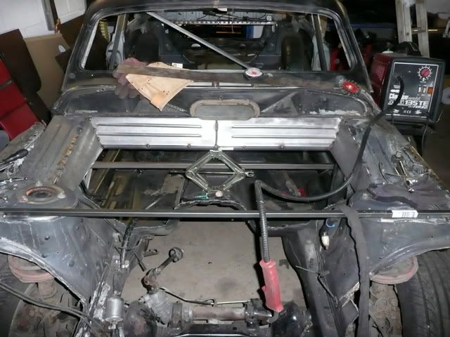

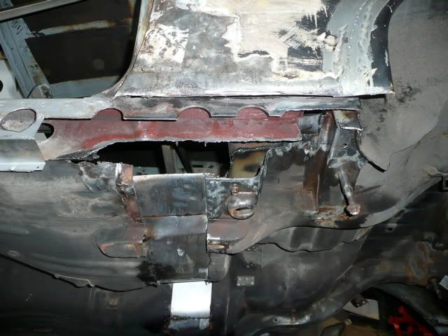

This weekend though, I did get some more fabricating done, starting to prepare the shell for the new floor, and also spotted a chance to move the engine back another 65mm. (it was already 170mm further back than a 200sx the front suspension is from)
Engine bay before:
And after, with additional engine setback:

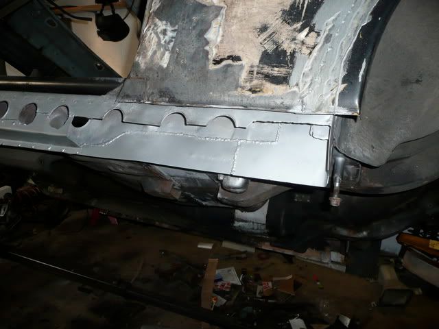

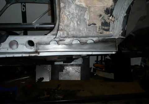

Sunday I finished 1 of the sills for the new floor and also linked to the front suspension turrets with a weird arrangement of a double a pillar with space for the exhaust silencers to hide inside. Difficult to explain so I will make sure I take pics next time. Airflow will be needed to deal with the heat, so it may soon be time to make myself a louvre tool rather than rely on the hammer and dollies for that many.
Engine bay before:
