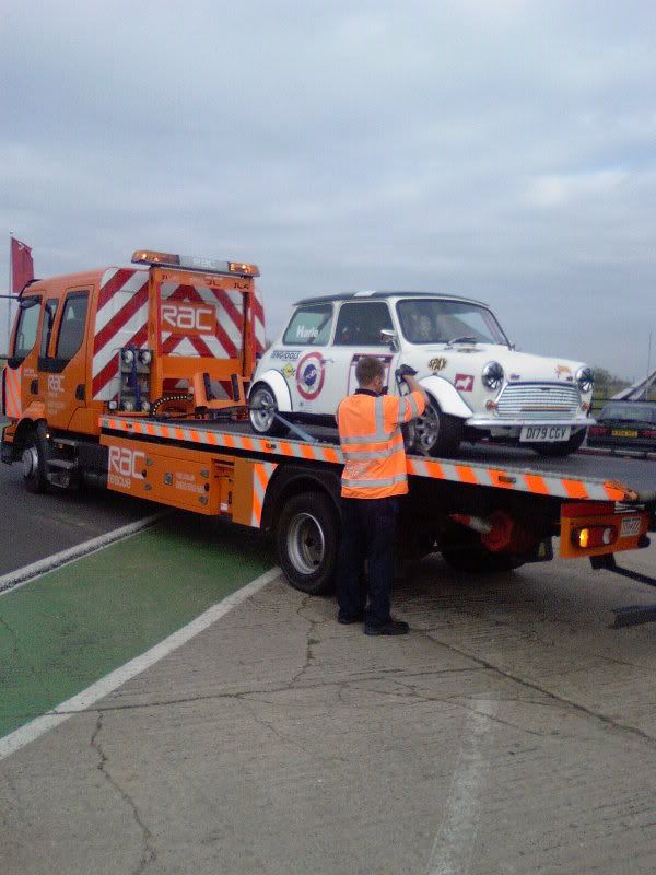

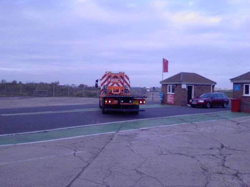

once i spoke to them, they said a patrol man would be out in 2 1/2 hours time to 'inspect' the mini, eventhough i told them that it's got to be trailered home. :roll: so he came, and went, he phoned HQ up and told them what the deal was, and i had to wait another 1 1/4 hours, and this turned up;

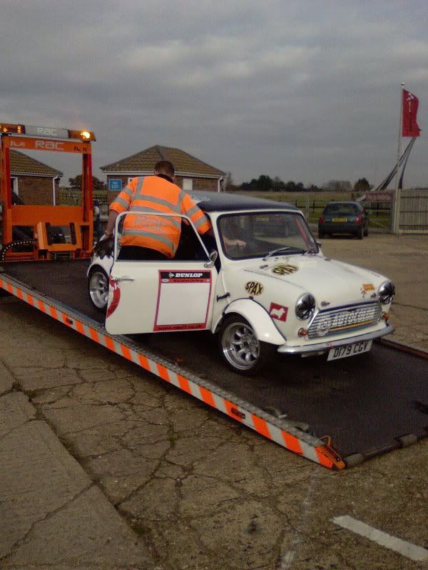

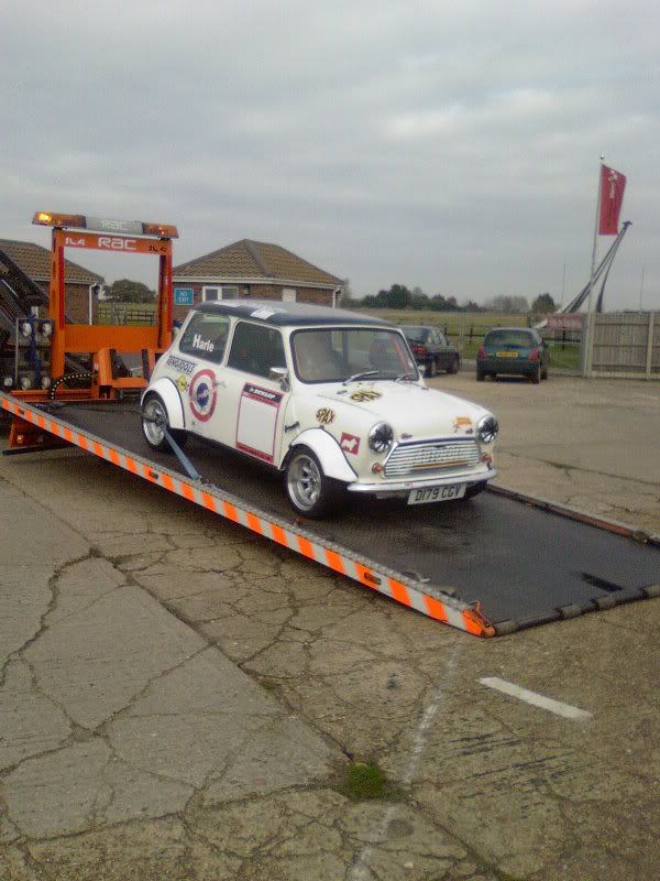

Spoke to the recovery chap who was very polite, and was very carefull with the car, due to it being very low :wink:
And then once it was loaded up, we then took the epic ten mile journey back to Thetford :P to inspect what damage lied beneath the surface...

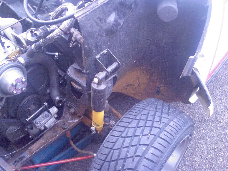

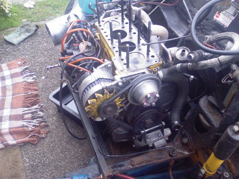

So, the engine;

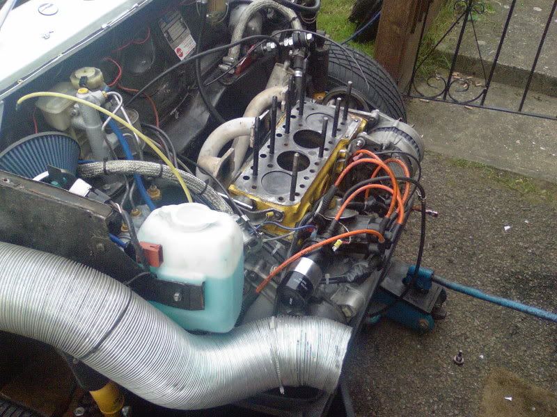

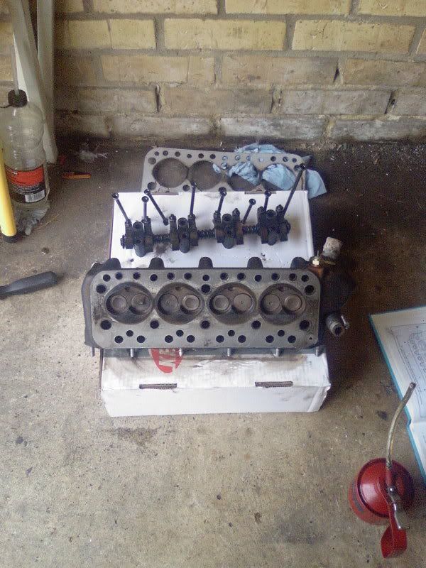

i wasted no time today in ripping it apart, eager to see whether i need a new engine or not, and here are the photos;

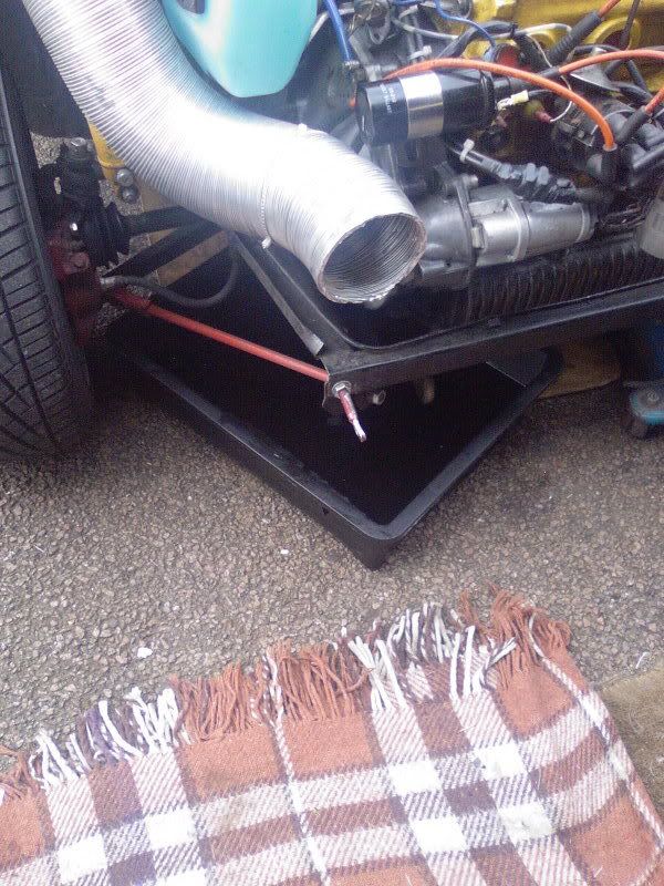

Where the rad blew; :x
oil and water drained out;
Despite this, the engine survived :D but i am very shocked indeed, after enduring the same temperature of over twice the boiling point of water, for such a small engine with no water jacket, i thought it was knackered, especially when the pistons expanded in the chambers :grin: so here's what happened;
A. The electric fan was running backwards. :?
B. The water pump went.
C. The radiator went.
D. The head gasket went (so obviously, whatever water was left went straight into the chambers, and then into the sump.
so, i need new parts, oil, oil filter, gaskets and some water to repair it :roll:

Check the piston rings - I had this happen to my mini and the rings went about 2 weeks later. Sorry to hear your day was ruined. :(
dynamix wrote:Check the piston rings - I had this happen to my mini and the rings went about 2 weeks later.
Yeah, i was thinking about the rings. They are pretty weak on a mini engine if they have a mischeif :(
