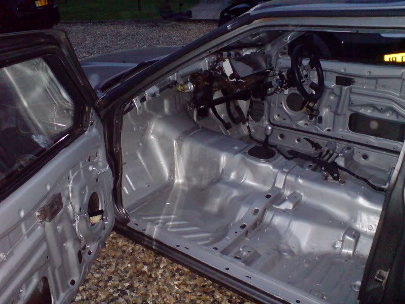

OK bit of an update i suppose.
Have done a fair bit of work on the Silvia lately,
Interior is now fully stripped of everything and i spent 6 hours chipping the interior tar and sound proofing off!! Nasty job i hope to never do again!!
Re routed all the loom onto the roof to keep it out the way of my feet etc, cleaned all the residue of tar off with a wire wheel and painted the interior with silver hammerite!!
Next was more weight reduction!!

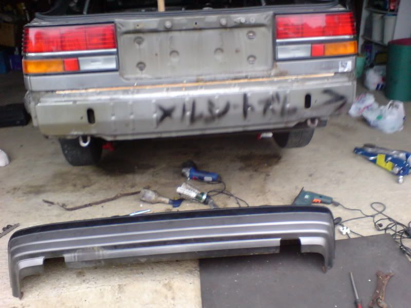

Removed and cut away the rear bumper support bar and just about every single thing else that was left on the car that could be binned! I cant find much else to get rid of now and still keep the car road legal!

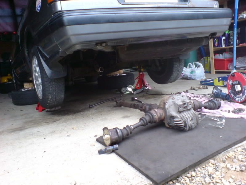

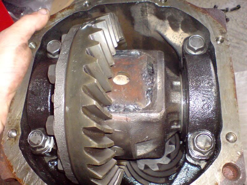

Next step was to remove the diff so i could get it welded up, not much fun lying on your back with a heavy diff on your chest but there we go, worth it in the end i hope!!
Then got the diff back and re assembled everything back together and now have a nice locked diff!!
Also have replaced lots of the tired old bushes with new nissan ones to try to stiffen the car up a bit more.

Makes me giggle when i see that diff as i got one of my work mates to spin the crown wheel and he didn't let go in time and wedged his finger between the casing and wheel, lucky he didn't cut it off lol... dippy git :lol:

Massive thanks for welding that up Paul, you did a great job.
