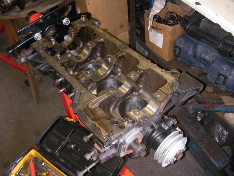

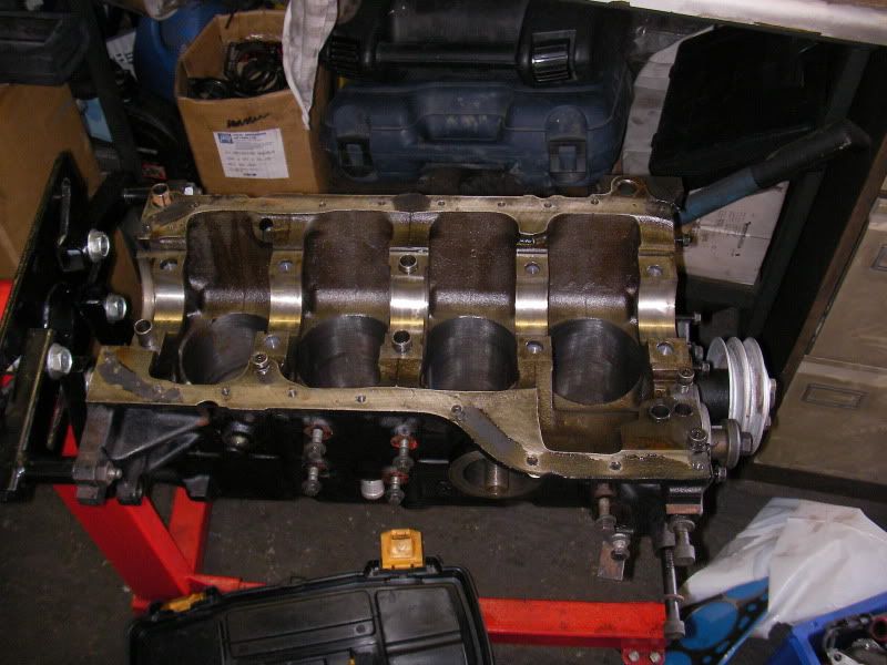

as paul has said the decision was made this morning to have the 1st block sleeved
so i spent today stripping the block down ready for the lining tomorrow
after the sleeve has been fitted gordon is going to get onto it and fit
pistons,rods and crank.
on saturday ill be going back over to rebuild the whole engine back up.
