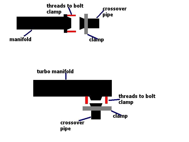

dunc its from halfords :-D seriously thow the cross over pipe is flaired out and the manifolds are flaired
in and because the car is so old it needs exhaust paste to seal it.

Sounds a tricky problem to get it to seal.
Is it possible to assemble the crossover pipe and then use some heat wrap, loaded with paste and wrap it around the joint. Reinforce with three jubilee clips, one either side of the joint and one on top of it? Or using whatever clamp holds it?
Piece of cake from where I'm sitting, with a cuppa. :grin:
gerry that is a good idea mate which i may just look into but it would only work on the off
side of the engine. the main issue is were it bolts onto the turbo manifold and its a absolute pig
to fit as there is no room to get under there.
there is a lot of cursing and swearing when fitting it :lol:
this is how the cross over sits on each manifold.
Is it possible to weld a short piece of tube into the bell mouth of the cross-over pipe that will sit snugly into the manifold and turbo manifold? If that were possible, you could then use a smear of paste on the bell of the pipe without it getting into the pipe iyswim?

that is a good idea but will have to look at that towards the end the season
when we do our next stage of development.
