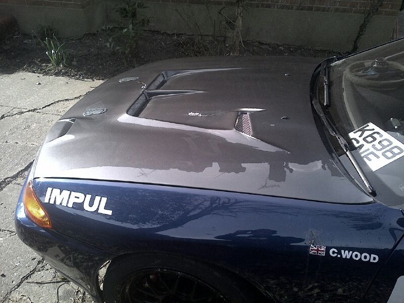

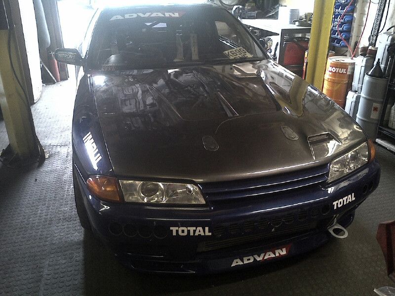

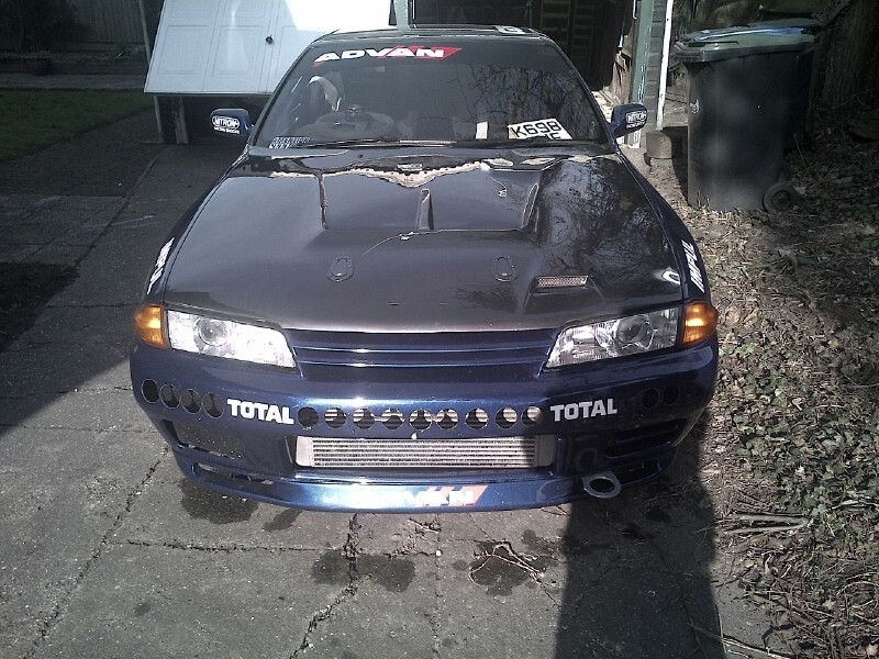

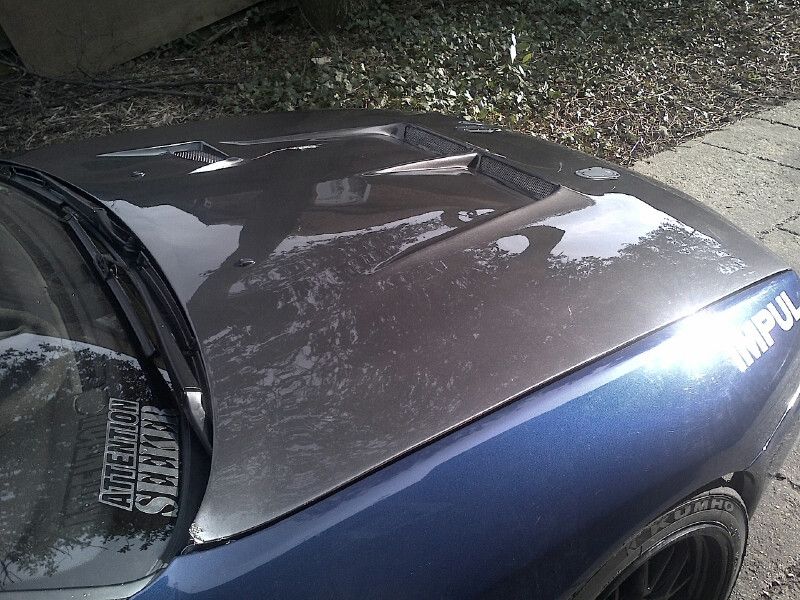

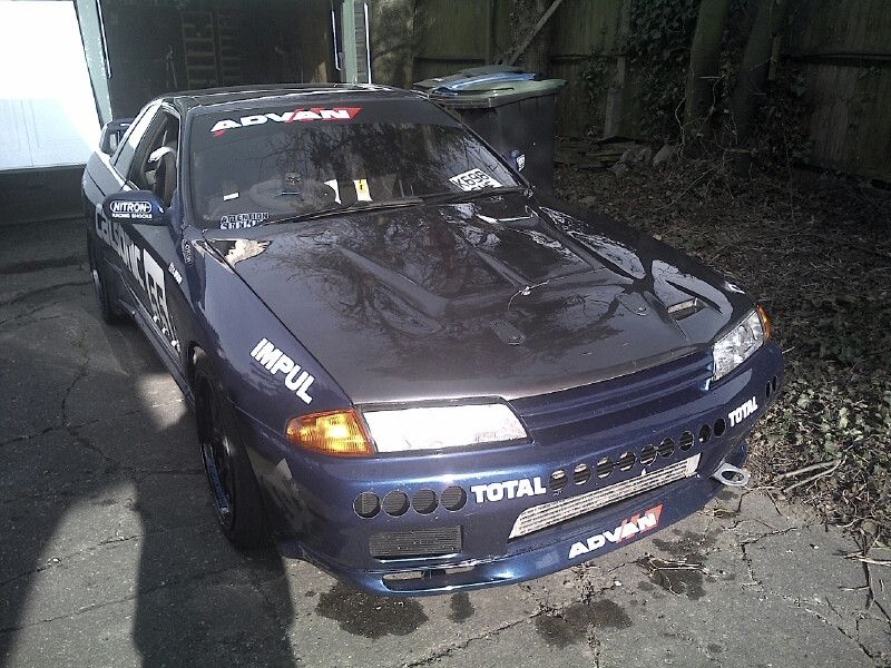

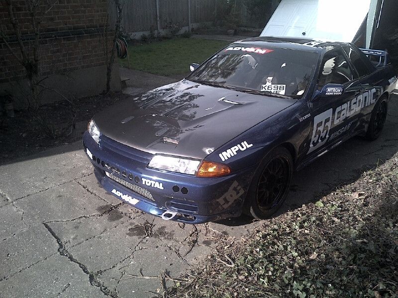

Hoorah, rather than sitting around in the garage forever the Carbon Bonnet is on
I have to say I'm pretty pleased with it, seems very good quality in that it fits well and also seems very strong - although slightly less so after I authorised Daz to cut the central strengthening bar out to clear the strut brace
I bought some new aero catches (my error being getting the "carbon look" ones which I'm sure I saw on paul or steves supra and thought looked good, but now I think look shit) and these were repositioned far more centrally. Daz also wound the rubber stops right up and after lots of fucking about the bonnet fits very tightly and feels very secure when locked, i don't think it will lift like the old one. The o/s is slightly raised from the wing but not bad at all.
I also took it to the bodyshop - more of which in next post and welcome advice - and sat in London 4pm traffic. While there I noticed that above the vent above the turbos everything went all heat wobbly, but not across the rest of the bonnet, so this makes me very happy as it means that turb heat is coming out, which of course was the whole plan
Anyway, also think it looks good so here's some pics

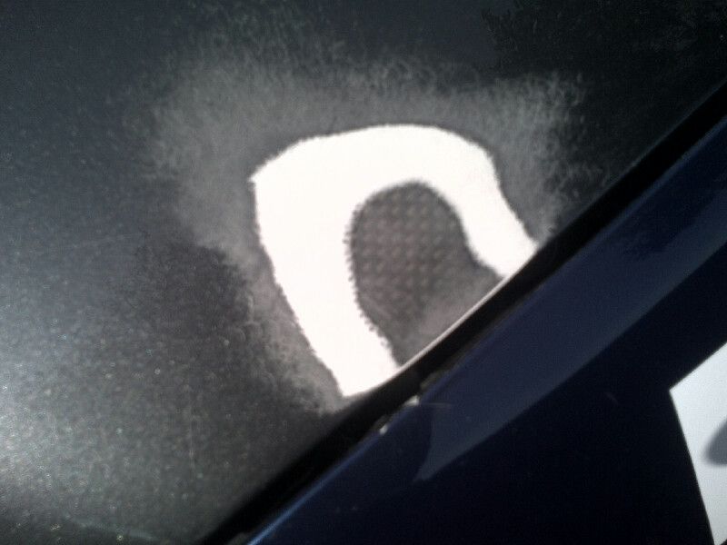

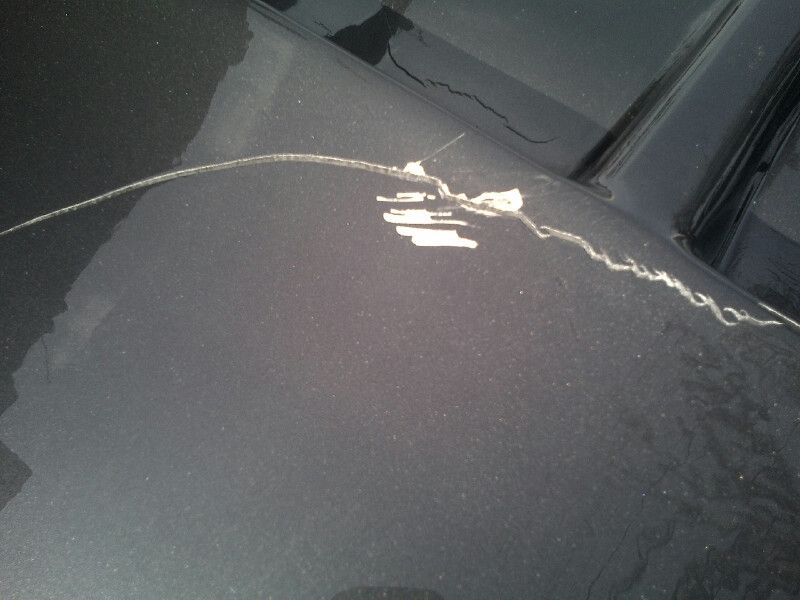

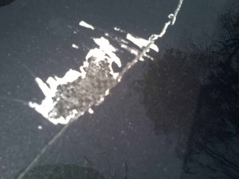

OK so here's where i need advice #1 - bonnet prep
As I hope you can see from the pics below the bonnet seems to have a lot of filler all the way across under the paint. I dont know why that would be, but then i know nothing about paint, filler, carbon, or pretty much anything really.
Here's where I rubbed it down to see if really was a carbon bonnet, or if i'd been stitched
Here you can see where it had a big gouge in it, and then the bodyshop man took a chisel to it
Here's some more scrapage
The weird thing is there seems to be a lot filler but it's all over the bonnet. Whatever it is under the paint is also soft in many areas - mainly where there;s been a lot of heat - you can literally stick your thumb nail into it.
Why would that be the case - is it just a shit paint job and shit prep. Or is the bonnet all cracked and fucked and held together with a bit of filler?
Anyway. The main advice i want is repainting it. The guy said he thought there was bucket loads of prep to rub it all back and quoted me 3-400 sheets for the job (inc painting it blue) which struck me as a lot. I do intend to get another quote as he did say he's not done carbon before. But my thoughts are, regardless of that, getting all that shit off is a bit of a job right, regardless of carbon?
Saying that, when I attacked it with Daz's disc thing it seemed to rub down ok, as per pic 1.
Anyway, i'm wittering on, thoughts on this?

Easy one first
Refit the Nismo lip........what's the worst that could happen
joking aside if the aerocatches and rubber bonnet plugs are flush with the bonnet when in the shut position then you should be OK.......it's just an unknown quantity until you hit 140+ I suppose.
Now, the difficult to pin down question
The 'filler/primer/undercoat' is difficult to quantify without seeing it but I suspect that it is primer that hasn't gone off properly and this could be for a number of reasons (paint sprayed on before the primer had gone off, primer not mixed properly prior to spraying etc).

Looks good and functional mate and I'd definately refit the Nismo lip
to be fair as soon as I saw that close up pic I thought it was more likely primer than filler but obviously I haven't seen it up close. Maybe there are a couple of gouges under there that have been fillered and then rushed over?
and I agree regarding the carbon look aerocatches (or anything carbon look for that matter) I don't like it. Have you considered painting them black/replacing them?
