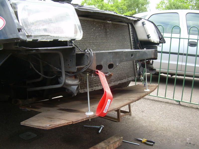

drilled the holes so rods would fit through to hold the front inplace
undertray bolted up into place and this time wont need bolting to the bumper like previous ones, also fitted towing eye do you think we'll need a arrow pointing out were it is:rofl:

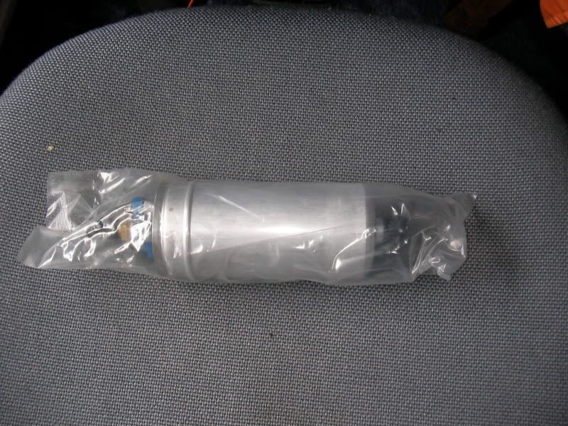

went to the post office depot this morning to try and find out were the it was after ordering it 2 weeks ago and thankfully they had it there.
its a RIVAL DA-27 305 LPH 650 BHP+ RACE FUEL PUMP and its one think we couldn't get replaced if it had gone missing in the post

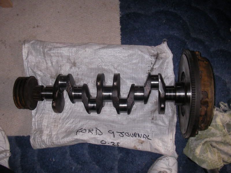

after picking up the pump went over and collected all the parts that had been balanced
you may just be able to see were he has ground part of the crank

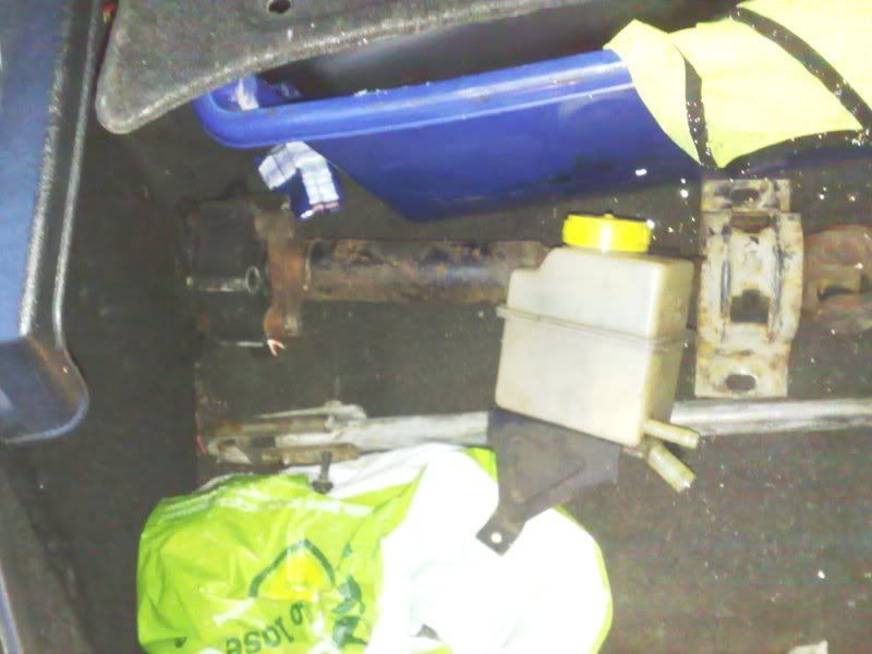

just got back from a 225mile round trip to swindon and back went and picked up a rear propshaft and a power steering reserviour bottle.
took a easy drive there and back doing 70-75 and managed a respectable 32MPG:rofl:
appolagies for the rubbish pic it was taken on my phone
