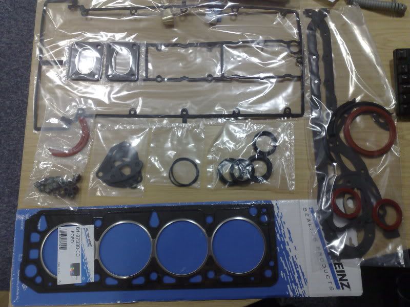

had a couple of deliverys at work today for the car
1st being engine gasket set
the other was the hiydrolic lifters but didnt take them out the packet
as they were in a bag and covered in lubricant and didnt want to get
any crap on them

Had a delivery today, Matt Lewis (Matt Lewis motorsport) kindly delivered some more parts to us:)

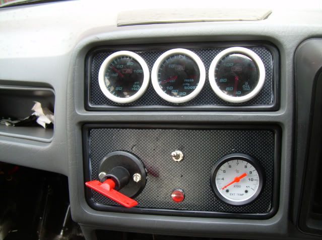

New pod for dials and cut off switch fitted
