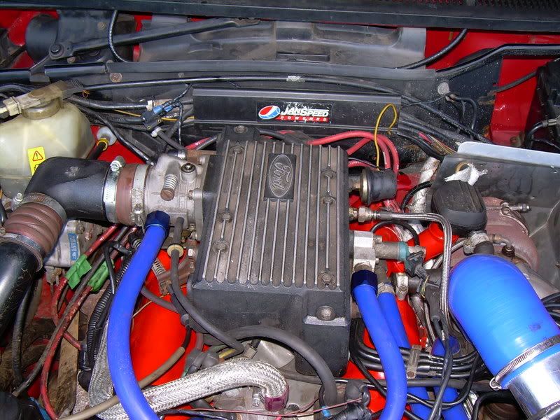

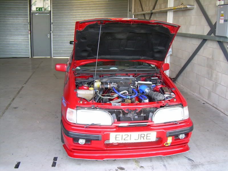

some photos of the engine from the track day at donington..
in one shows the water all over the header tank bottle and a bit hot :x :x :x
hopefully over the winter months get all all clean and shine under there 8) 8) 8) 8)
