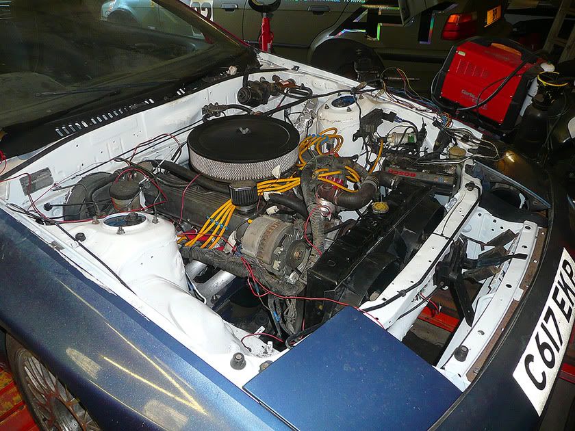

Back and focusing on the RX7, this morning I fabricated a tool to measure the required movement and we got the clutch to work for the first time. Shortly afterwards a new slave cylinder mount was fabricated and to match the movement needed I sellected a mazda MX5 slave rather than the giant SD1 unit.
The results... We drove the car for the first time!

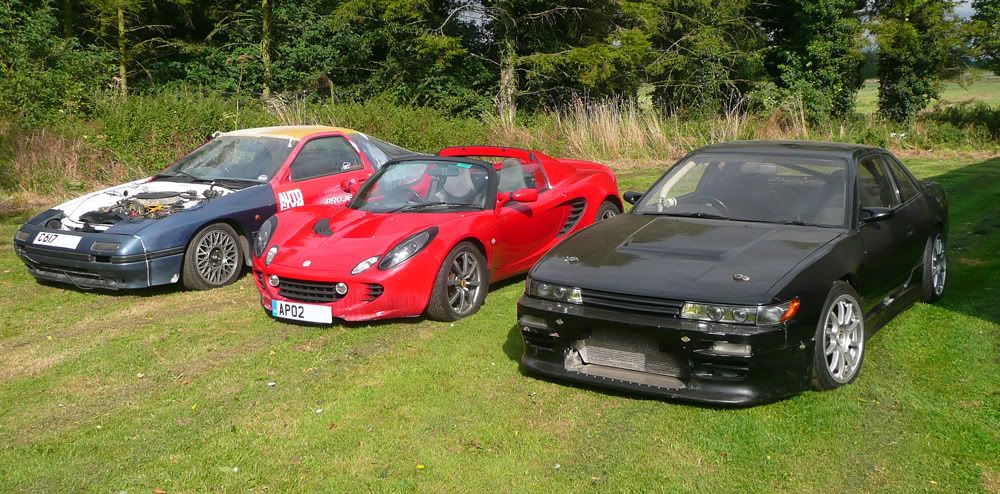

I have a video (.MOV file form a digital camera) if anyone can tell me how to compress 75mb of a 50second video so that i can put it in my photobucket acount. But here is an engine bay pic and one of a few of the toys together for now:

There is still a bit to do to get it on the road, but it makes moving it on and off the ramp so much easier now.
- Gearbox mount still not quite right
- Engine mount blocks need re-making from something other than steel (nylon)
- wiring harness is a work in progress
- interior hasnt been started
- body prep and paint to finish
- rear dampers need to be fitted with new collers as the old ones are siezed
- exhaust valves need to be sourced so it can run open manifolds for a really rude engine noise!
