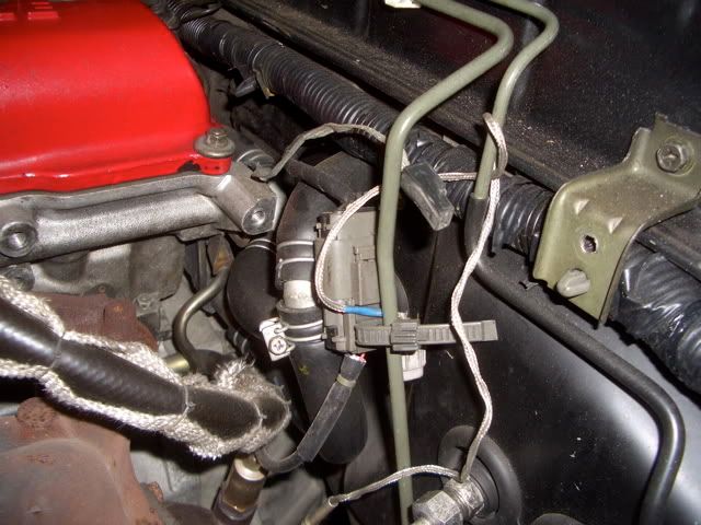

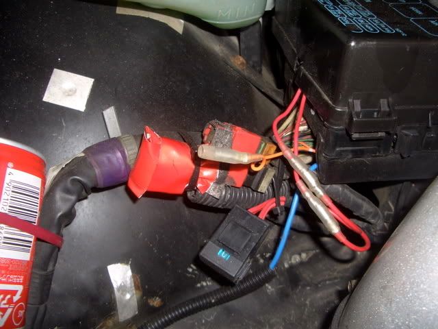

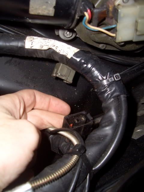

To give me some confidence in the car I started checking the engine bay harness for frays or shorts. What I found was a variety of hacks and several plugs with nothing obvious to plug into.

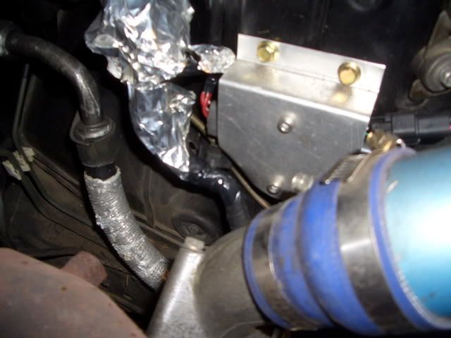

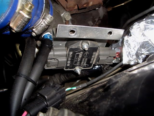

and a homemade plate beside the turbo, bolted to the suspension turret hiding anther black box:
coil amp pack? no idea what it is to be honest.

I think the shielded box of tricks is the ignition amplifier as you mentioned, it's probably hidden behind there to try keep it away from the heat. I know from first hand experience they are very susceptible to breaking down when the car gets hot and then behaving ok when cold. Over time this gets worse until the car runs on less cylinders than it should or won't start altogether.
