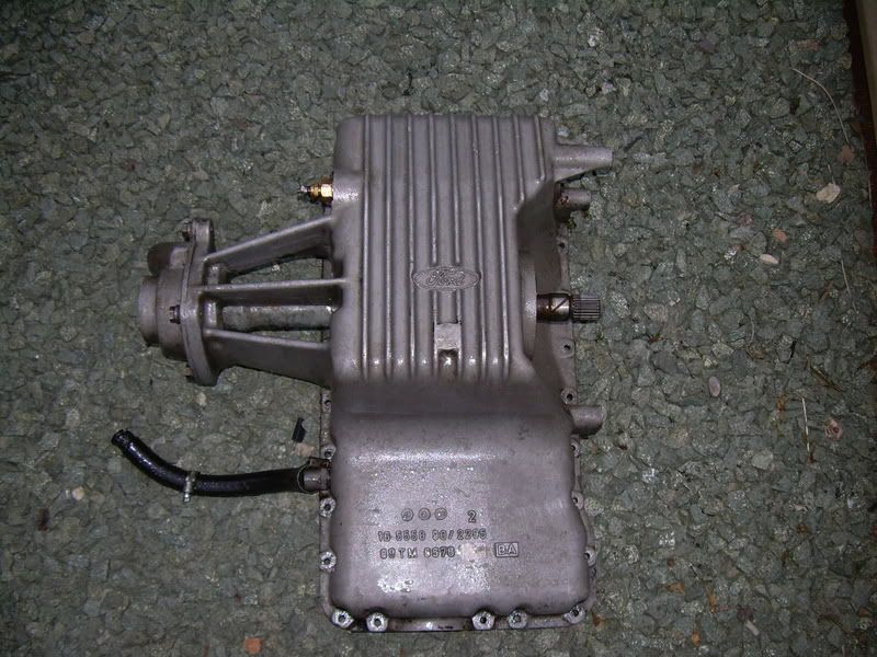

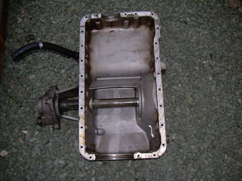

Cleaned the sump up a bit today, just waiting for the guy to get back to us about baffling it. Might have to find someone else to do this as time is pressing on :)

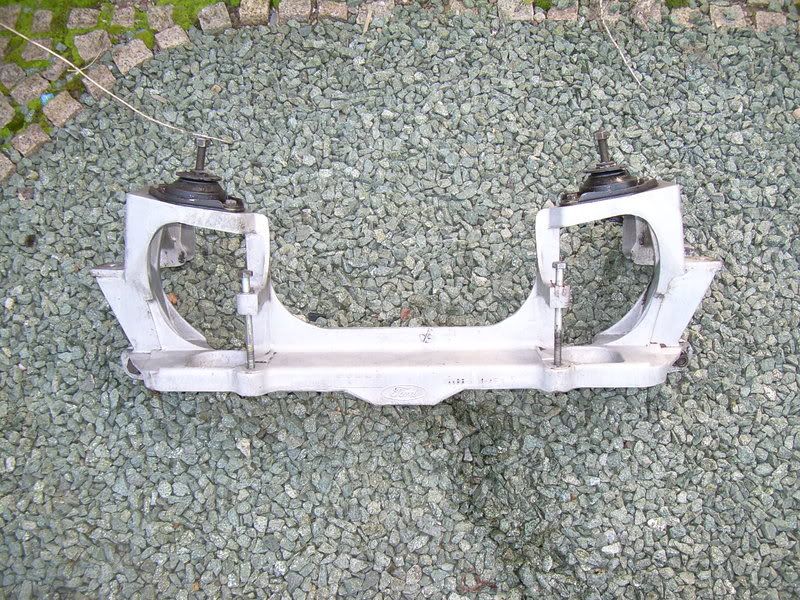

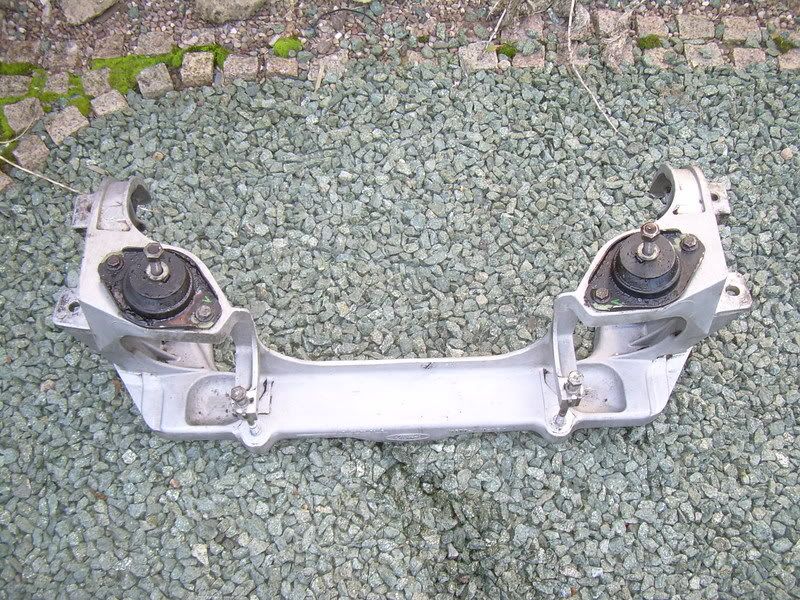

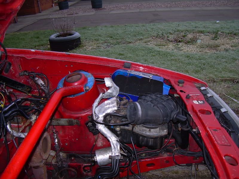

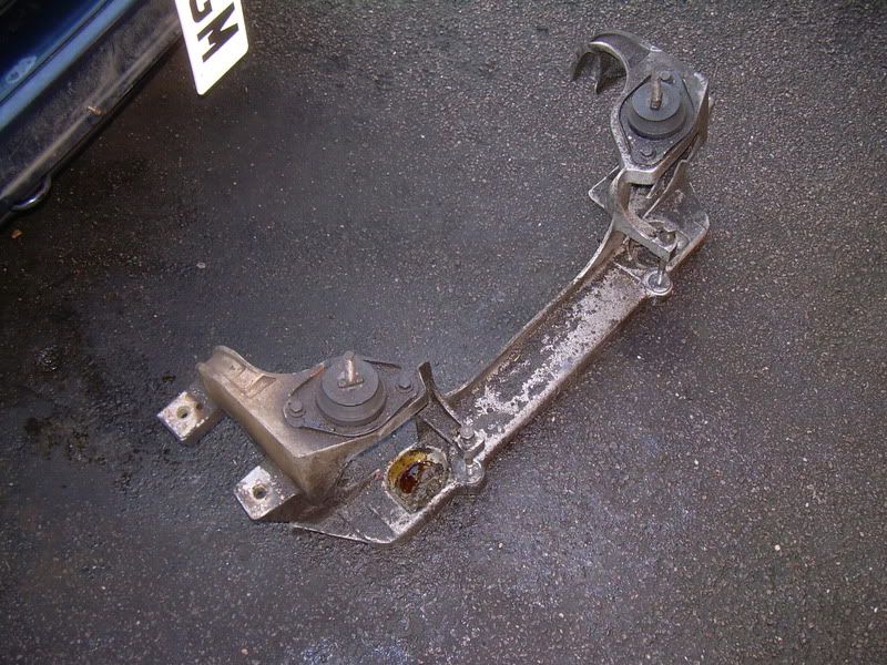

As we're getting close to the time of re fitting the engine thought i had better get on with the cleaning jobs. So today tackled the oil and grease soaked crossmember and this weekend will be tackling the engine bay :(

Post by Coyote »
Now that looks better eh!
It needed to be done it was minging, just got to replace the engine mounts as one is split and wobbley :roll:
A bit more work done today starting a couple of jobs off the long list :)

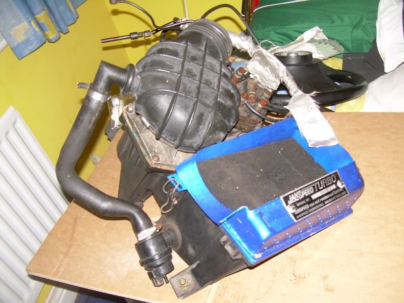

Air intake syatem removed in order to design and fit a cone filter with direct cold air feed.

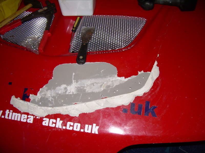

Next job started was on the bonnet to repair the crack from where the evo vents were fitted. Now looking like it will be a bigger job than first thought as all the original filler will have to be chipped off :(
