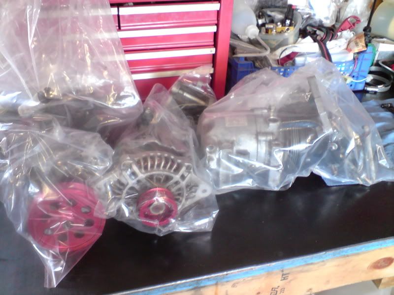

Got a bit of time this morning so started stripping the ancilleries off the 207 motor. These will all be going on the 257 motor in some way shape or form.
Spent the time cleaning everything as i came off, some larger stuff will be chemically cleaned and/or beadblasted and refurbished before going back on.

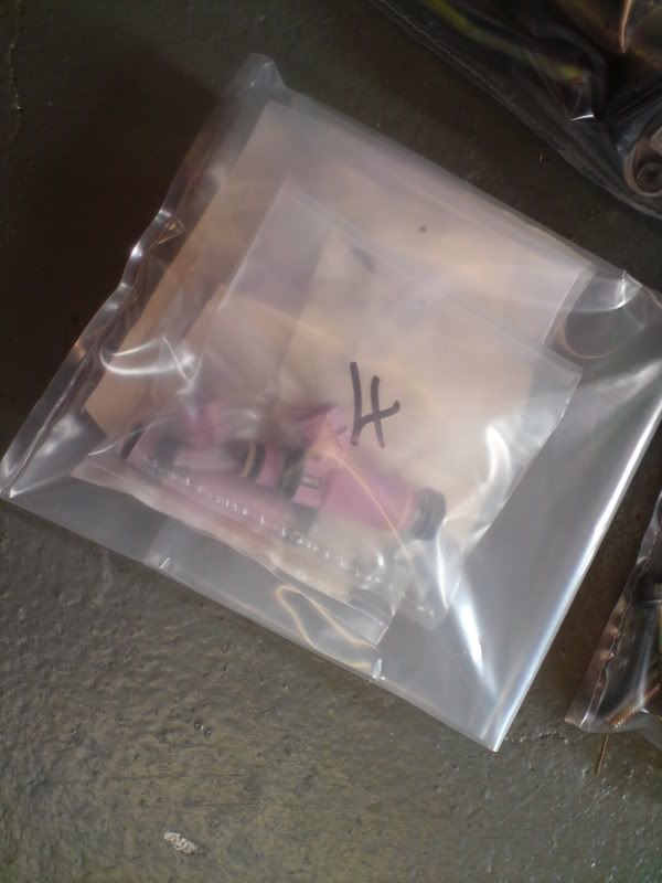

All the important stuff was tagged inc all hardware removed. Everything was then bagged and sealed.

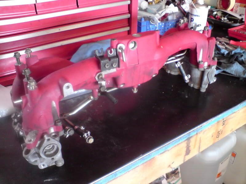

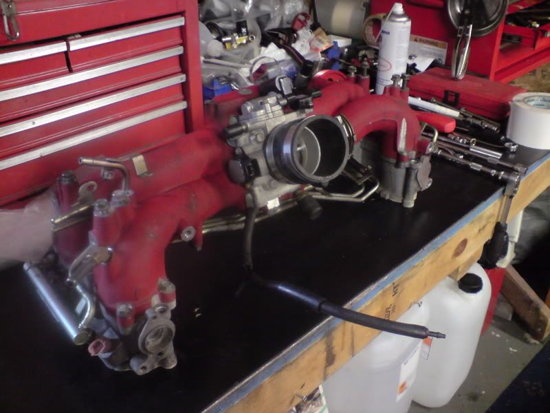

Heres a few snaps, inc various stages of the stripping of the intake manifold.
(Also found out that my manifold had the JDM TGV'less bodies on them, but im still gonna fit the spec C intake.

Are your original Pinks std 550cc or are they modified?
I thought STi8's had TGV's deleted, mine doesn't have them either.
By the way....nice job bagging and labelling everything...very methodical :thumb:
