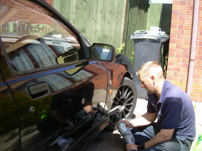

as it was a nice day one of the jobs we have to do is sort out the paint on the car, it did have a respray before we bought the car but to be honest its not that great so with my brother leading the way on flatting back the paint and buffeting it back up the one side the car now looks loads better

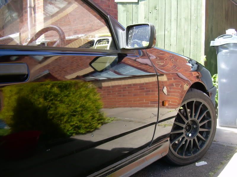

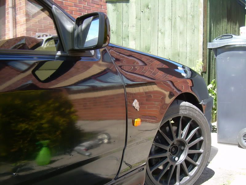

after 1200 the wing, G6 and then polished buffed up the wing

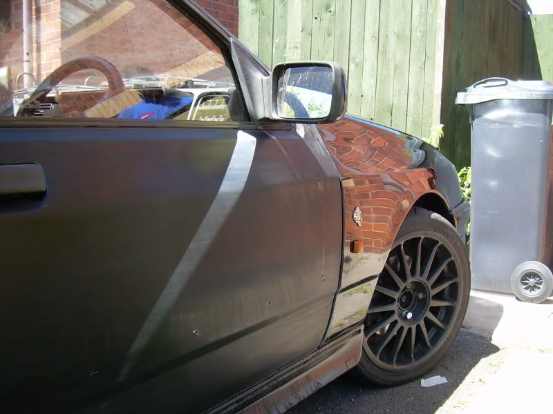

in this pic can see the difference between the front wing and the door, follow the line of the bricks
after using 1200 paper on the door
after some G6, polish and a buff

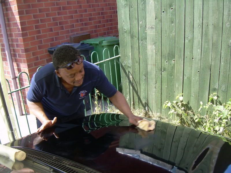

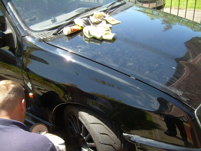

pablo polishing the bonnet
