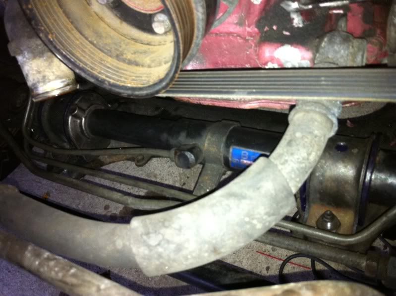

Whilst I was under the car I also took the opportunity to fit my Superflex steering rack bushes.
Crap pic of the day, you can just about see the blue of the bushes through the brackets

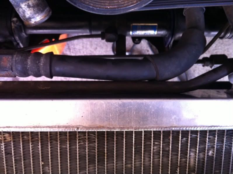

Right a better update. The biggest problem I have is the oil cooler pipes have a metal pipe that Mazda decided to not make straight and put a short bend towards the front of the car. If it was straight there wouldnt be an issue and I cant bend it round
Anyway I have taken the brackets off and managed to move it enough but it is pretty tight against the radiator. Not sure how much of an issue this is at the mo:
Anyway a bit of pushing and managed to wedge some tubing down there to help:

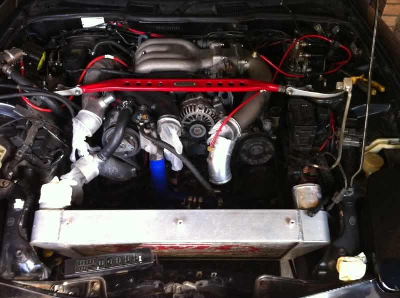

Then it was on to trying to bolt up the rad and getting the intercooler in to test fit the pipework from the rad with all the bits in and seeing how it sits, I present to you......

cant believe ive only just seen this thread lol! Didn't realise you had a 99 spec nose. Looks awesome mate, and the FEED sidesteps will set it off real nice.
Personally now you have the car in bits I really would remove the airpump. I take it you have a decat so its pumping to nothing? Also id get the aircon out as well if you don't want it. You can feel the improved throttle response straight away from less parasitic drag.
Both are a bit of a pain to do but while its all apart it will be MUCH easier to get it all done now.
Let me know if you need a hand.
