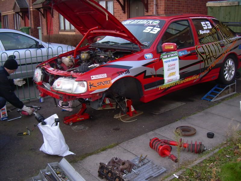

A bit more done today. it was raining and cold most of the day so decided to take the manifolds off the heads a right bitch of a job :evil:
At the same time i thougth i would take the old wasste gate off aswell. Took an hour to get the wastegate off :( That was the easy part had to cut most of the bolts off to get the turbo and manifold off th head and these were all new bolts 2 years ago.
Found another problem as well the manifold on the turbo side had been leaking :roll: A couple of hours work left to do and we should be ready to drop the engine :)
Another weekend and more work to be done on the car tomorrow. The plan for sunday is to remove the suspension, hubs and brakes. Test fit a new propshaft, make up template to allow relocation of wastegate and a few other bits.
Alan has also started on a new front bumper he took the 2 bumpers home with him last week and had it made in rough in an hour. It weighs about half as much as the current one and offers better cooling. Along this line he is also planning to relocate the oil cooler.
Pictures of our progress will be put up tomorrow :)

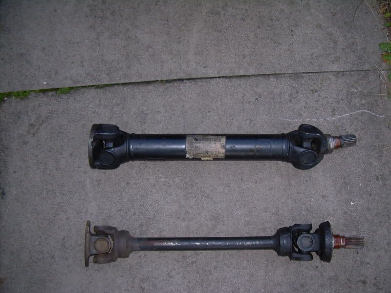

This is the new front prop that we were test fitting. A bit bigger than the current one. Abit of work will be needed to make it fit.
