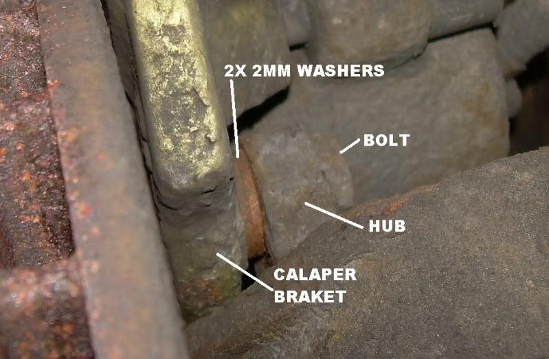

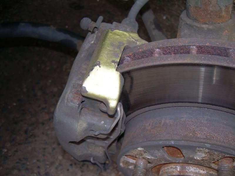

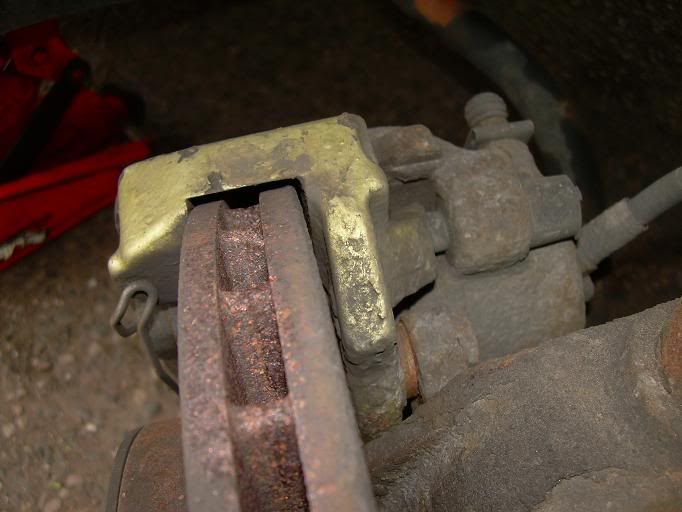

here you go mate, just a point the washers have to go top and bottom.
just for bit of piece of mind this is the exact setup we have on the race car with the washers in place and had it for about 3years this way.

Do the bolts need to come from the standard existing kit, or do I need to source some 4x4' carrier bolts?
can use the standard ones that are on the car thats what i have.
