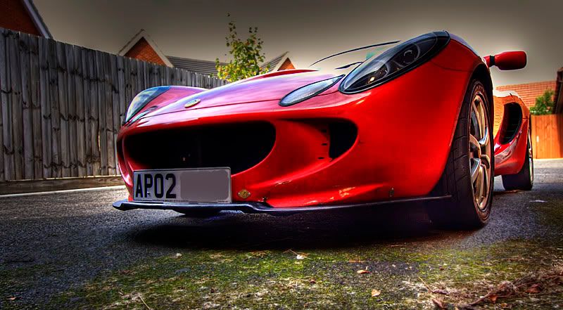

It is finally done! The splitter has been made, given a lick of matt black (I am not a carbon fibre tart) and the clam modified. It can now be removed in less than a minute, but is a lot easier with an assistant due to the size of it. The fits and shuts still need some work, and the clam still needs repainting and new grills, but I am taking the car of for a few days break so will worry about those issues in a week or so.
Will post the pics up a little later.
RPS13
Posts: 249
Post by RPS13 »
And here are the photos of it finished and back home:
The back is held by an Aerocatch on each side, with a lock for a bit of security. The front fits over a mount on the splitter and crash box structure with 4 dzus fastners holding it down. The only connection to remove is for the lights so it is a fairly quick process to take off now. I want to do the rear too which would be even more useful since everything is back there, but that is going to be really hard and this was painful enough for now.
I have photos of the laminating process for the splitter, but they arent very exciting. They will also remind me of the 4 nights it eventually took to make after a vacuum pump let me down half way through the layup. I will have to find another before I think about making any more parts.

RX7 wrote:Very good mate !!!
Love the pics, is that a spot of HDR ?!!!?
Glad you like them.
The top one is a single RAW HDR, followed by sharpening and curves contrast adjustment in Photoshop. The lower one is just curves, red saturation and the dodge brush to underexpose the splitter and front of teh car so it can be seen better.
