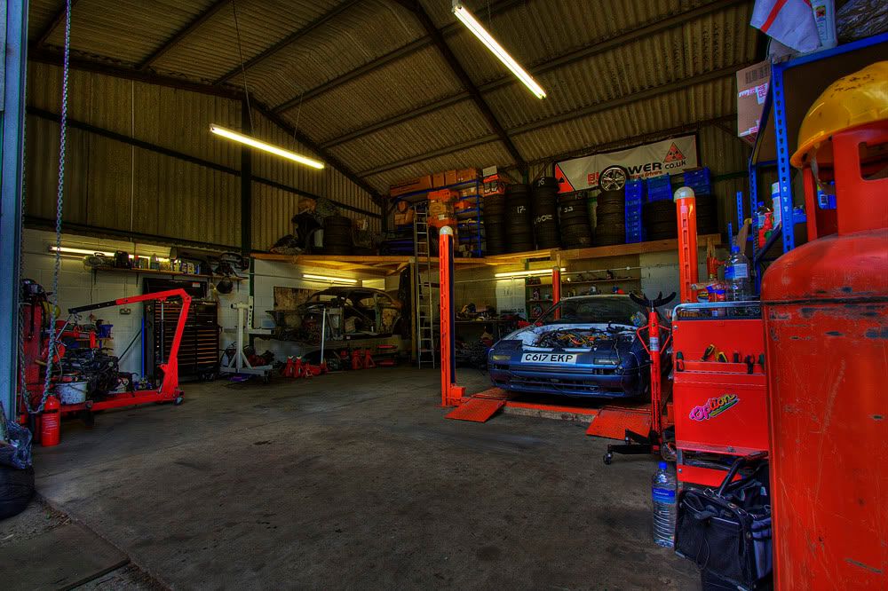

So, I went along today intending to at least get more prep done on the body and maybe start the interior. Instead, the whole boiling hot day was spent clearing out the workshop and making more space to complete the 4 projects currently on the go in there. At least it looks good now:
Oh Rob, that looks awesome! I have a new wallpaper now :)

how tidy :)
