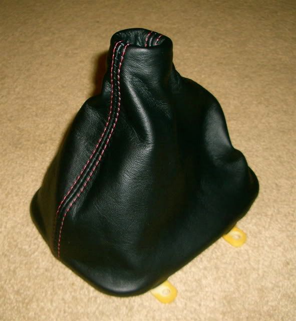

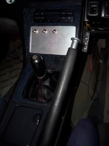

New gear gaiter already done in black leather and red stitching, and all for a packet of tobacco! Thanks Fred if you ever read this.

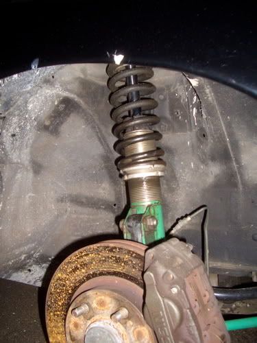

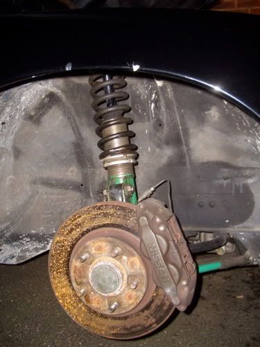

As for ride heights - there was just 1" droop at the front and that was almost all spring slack, rattling around on the shock. I took up the slack so the spring was now seated properly when the wheel was raised ( much much safer now), and still silly low but should just about give me speed bump clearance if i am careful. The rears were also raised a little but most of that was then lost with the smaller diameter of the 16s.
Front shock before and after:

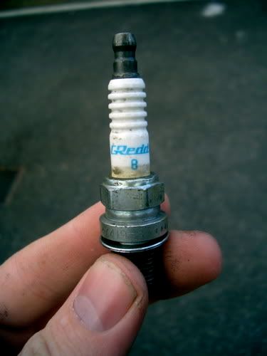

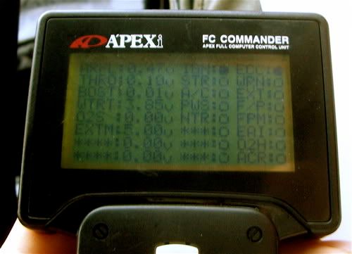

This afternoon I tried the car and even draged Celica Dave into help. The engine had no spark of any form and i just cant work out what is going on. Car electrics are my real weak point, and a hacked about wiring harness for a Power FC, Boost controller, turbo timer and a range of other things i have no idea how to use properly has me completely lost. My car electrics expertise comes down to reading an error code of the OEM ECU and fixing or replacing the offending sensor. The best a Power FC could give me was a sensor check and that left me none the wiser:
I reads the engine speed when cranking so it cant be a dodgy crank sensor. I have used a booster too so it cant be a weak battery. It has coil on plug, so it cant be a dodgy coil pack otherwise only one cylinder would be down. I am just lost now.

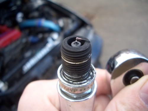

Oh - and the "freshly serviced engine with new plugs" advertised had black oil and some very old looking iridiums in it.

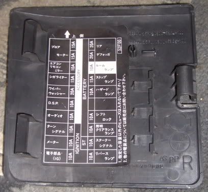

Can anyone read japaneese? I wonder what these fuses do?

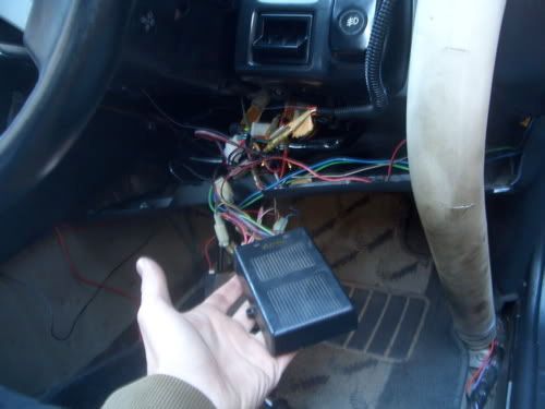

An what on earth is this thing under the dash? I dare not play with it for another electrical issue to arise.
