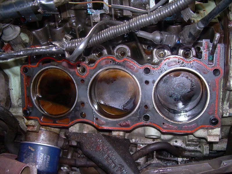

Following a closer inspection no visible cracks have been dectected in the top of the block. The head gasket on this side of the engine was looking fairly battered. We then started to look at the time line of his problem and it stems from when we first built the engine.

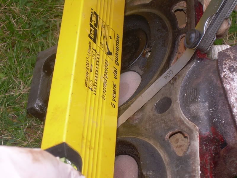

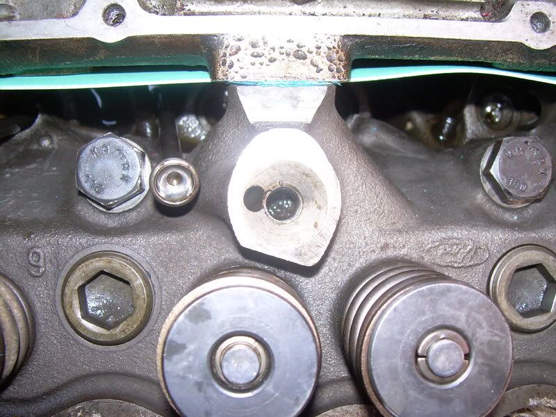

We decided to check the original heads to see if there was anything on them that might have damaged the gaskets......What we found was this :o
Either side of piston 2 we could get a 4 thou feeler guage in :( . We compared this to the current heads that we are running No gap.
It appears that one of the original heads was slightly warped, coupled to the fact that we originally torqued the heads down to 95, now torqued down to 115. This caused the original, standard gasket to blow. It also weakend the velpro gasket that was subsequently fitted.
This however is still only our summise. The current heads are still going to be checked and skimmed and new velpro gaskets fitted, if nothing else this will eliminate another possible cause.

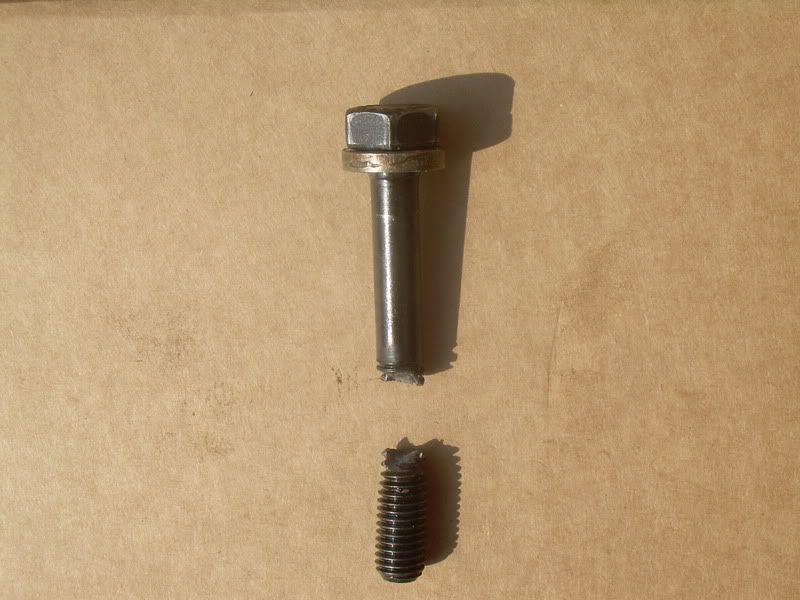

OH BOL***********LOCKS
Snapped a bolt torquing down the rockers :x
PHEW!!!! Managed to get it out :grin:
You lucky sod! Don't know your own strength mate :D
