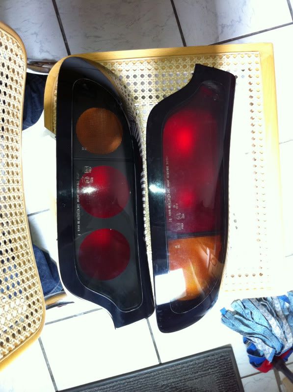

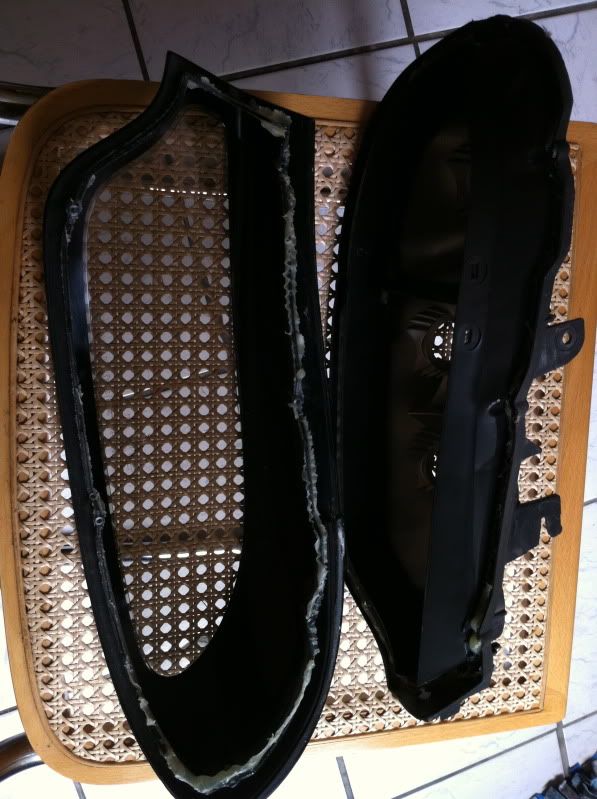

So decided to do a bit of work on the car, first up 99 spec lights.....
You have to heat up the rear lights and split them to reveal the interior....

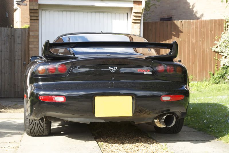

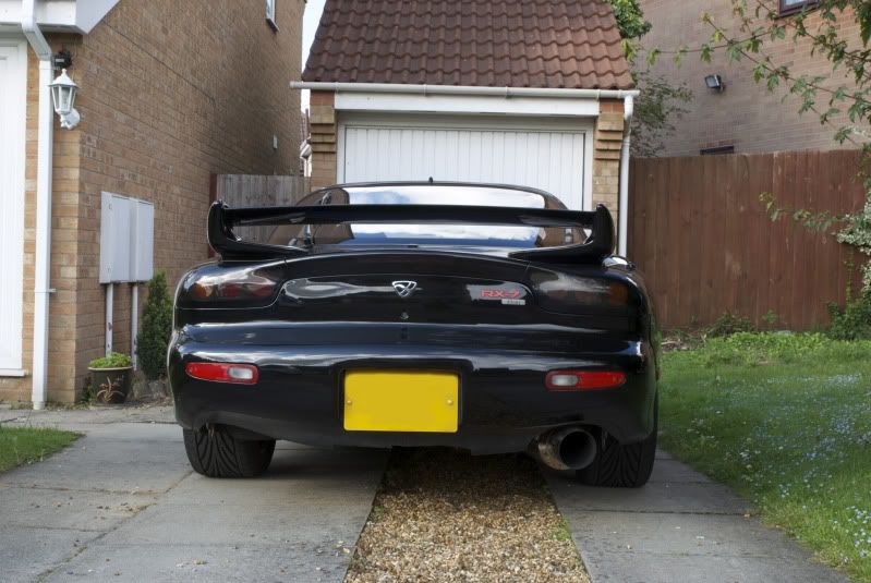

Then its a case of refitting back on the car so you have this.....
Off
On
I do like them, they look a bit better than the bog standard square light versions.

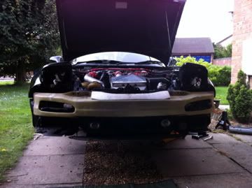

Also had to chance to do the mod I have wanted ever since buying my car and seeing Andrew (from Jimmys RX7 specialists) and his Spirit R (last ever 500 RX7s). It is a bumper from the 1999 -2002 RX7s.

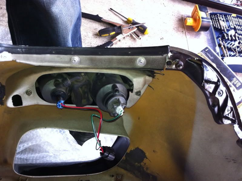

It took a fair amount of work getting the old bumper off but the biggest issue was trimming the reinforcement bar to fit with the later spec lights which aren't oval like the old ones. All I can say is that I am glad I invested in a Dremel, what an amazing device that is !! Well until I had to use the smaller cutting discs and kept breaking them. But it certainly made the job quicker.

Then it was a case of bolting the under tray back up etc, there are a few gaps because the trays under the oil coolers slightly different than the later spec one. May invest in one later but when I was given the cost of a 99 spec reinforcement bar of

I will have to eat my hat as I remember saying that I thought the '99 upgrade was unnecessary..........wrong! The rear lights look like a labour of love; I never knew how it was done and the results look really cool :thumbs:
