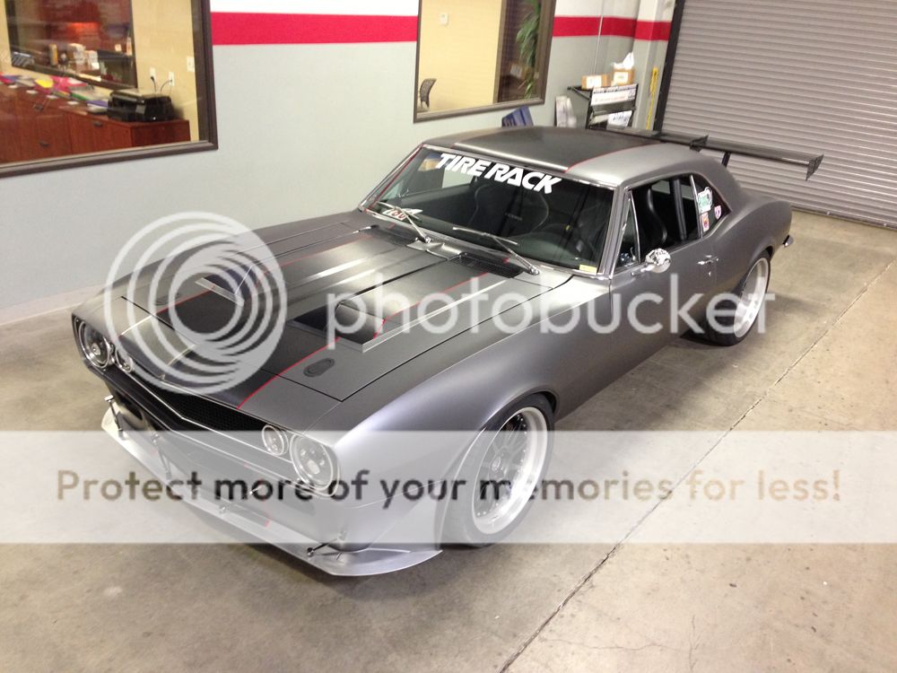

And here are some pictures of bonnet vents on pro touring Camaro's , these things get used on track Image

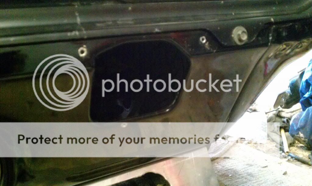

Job number three was to bolt in a better towing point which i did using a strap fixed to the inner wing , i got access through a cutout in the front panel were the bumper was fitted . I also filled in the cutouts with some tin panels as they let air in the front , it sort of cleaned the front up from an airflow point of view .

the bumper cutout
bit of tin for cover
you can see here the tow strap poking out from the cover which is a bit dfficult to see here as its a black cover on a black panel , but it looks better and cleans the front up
