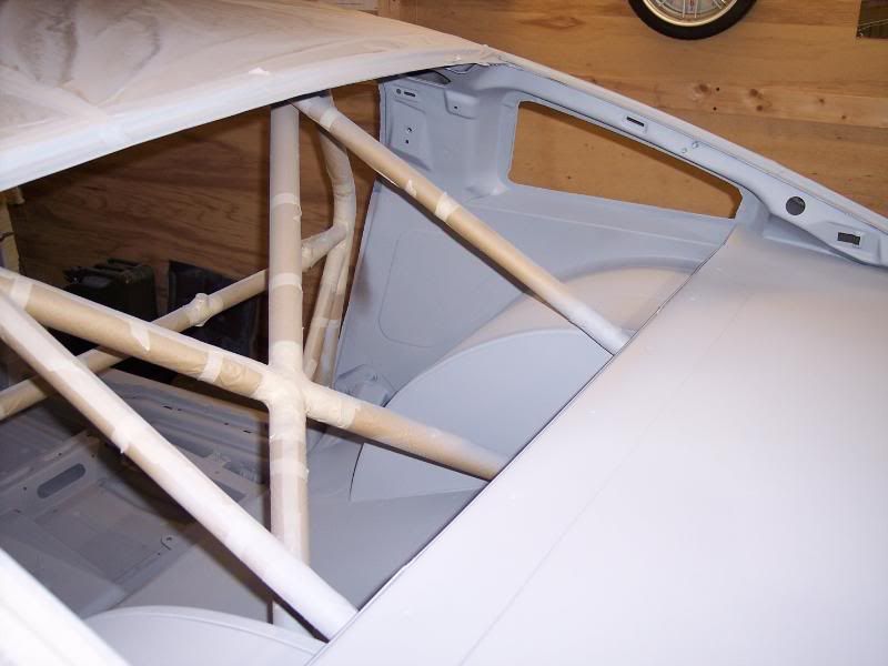

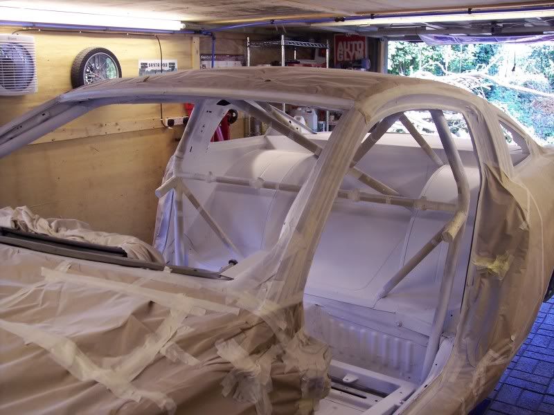

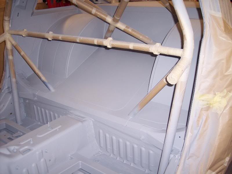

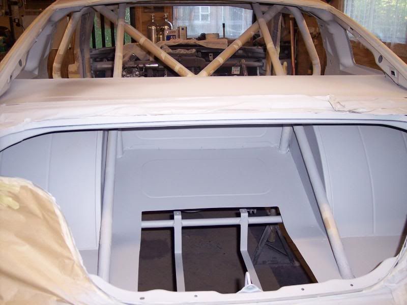

Once that was done and dried I then covered the car with white primer

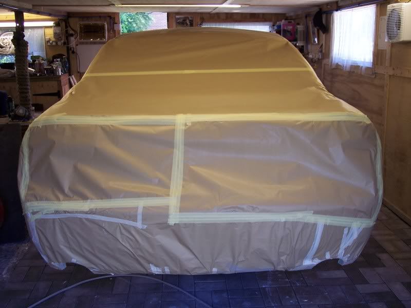

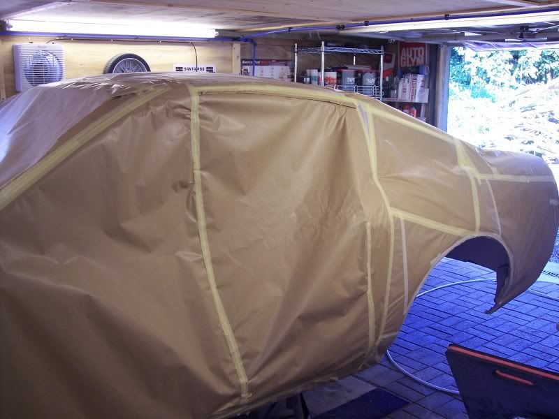

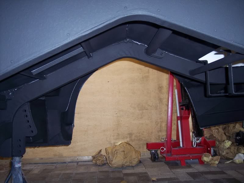

I then needed to sort out underneath the car so I masked up the whole car in case of over-spray

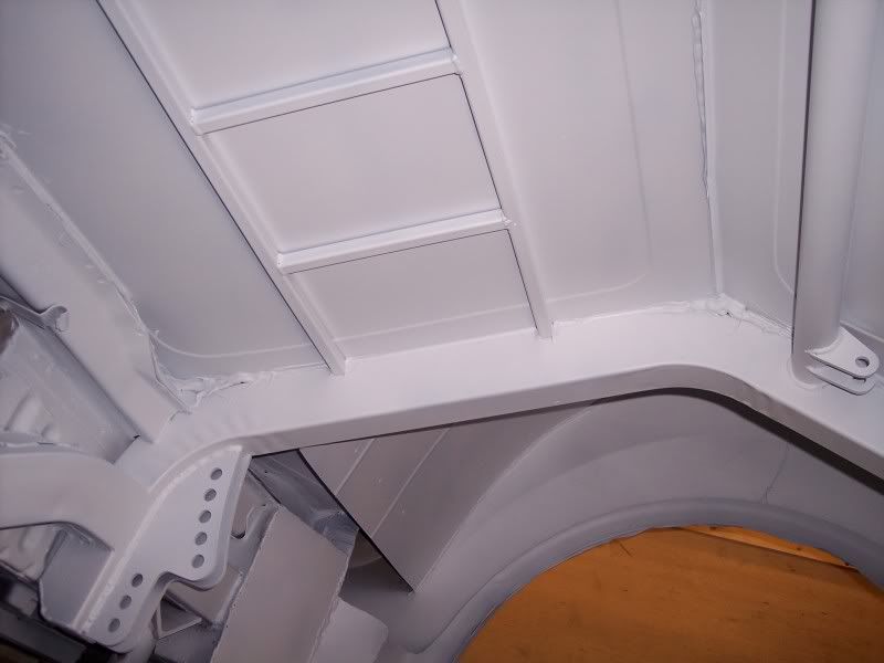

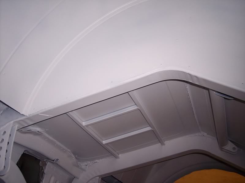

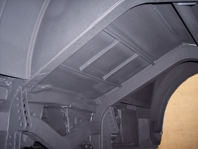

Next came the spraying of etch primer followed by white primer again
Once this had dried I covered the whole underneath with a protective anti stone chip paint
The next job will be the crucial one which is to spray and lacquer the car interior with blue to match the original paint
