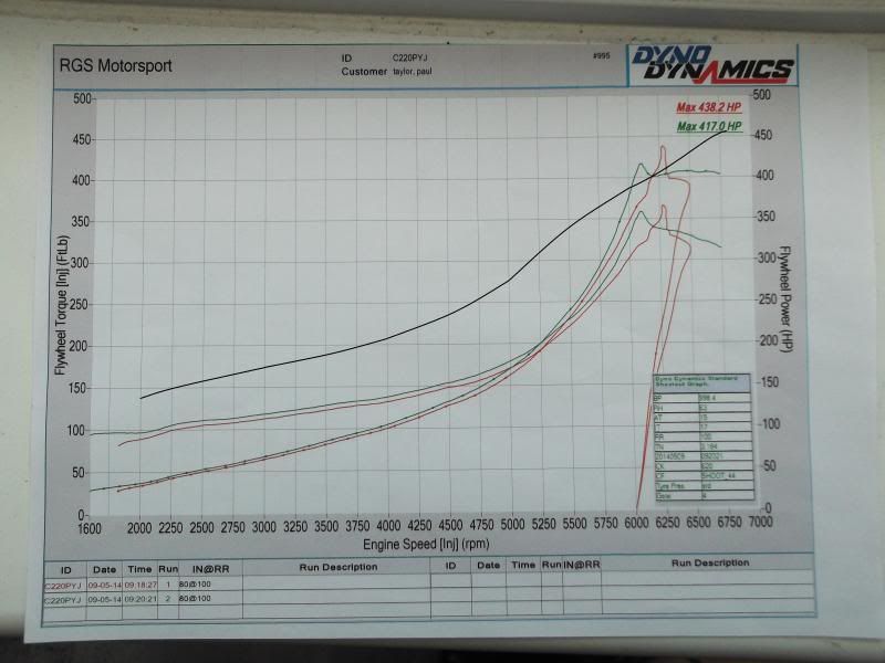

Wow thats interesting, sitting here looking at the graphs from Gary's dyno day in 2012. At 4000 rpm it's making the same power but at 5000 rpm we now 100 bhp down but then it climbs a lot steeper.

And there was me going over old graphs and fretting over the lag from my T3 on the RST!gary@apt wrote:sorry but what the fuck!!!, is wastegate stuck open??
That graph/power delivery is shocking Pablo- a 750rpm powerband? Ross' drag Evo had a wider curve than that!
Looks like the 438bhp run was aborted? Possibly due to wheelspin causing the unrealistic 'blip' in the graph?

right, I have dug out our power graph from 2012 when it produced 451bhp.
I have taken the graph and copied the power curve onto the one from yesterday, black line
http://i15.photobucket.com/albums/a385/ ... e6f0c8.jpg
anyone have any ideas?

Now you know why we sruggle on track, when she comes on boost she's quick, but boy is she laggy.
It was aborted, but due to the guy watching the rev counter which can't keep up when the car comes on boost (itis 28yrs old). Instead of going by the shift light which is contolled by the omex.
Sitting here thinking about it and i've no idea if it has had any affect on the car, but. Since we changed the diffs from 3.62 to 3.92 (for better acceleration) the car has not been remapped. It's only ever been checked over to ensure fueling was good. Then we had that issue where we found out that the car was only boosting to 18psi.

But you can see why we thought we needed more revs from the engine

We now have a new tuner and Friday was the first time they saw the car. They wanted to see the car and put it on the dyno as a basic health check before doing anything.. They haven't seen any previous dyno sheets but said that they would expect to see the boost coming in about 1000-1500 earlier.

I only ask, because I have a feeling that it's a similar problem to what I think I have with the RST [off topic bit] where ever since I had my stage 2 T3 recon'd, it's always felt laggier. Now, the only difference between a stage 2 and stage 3, is a larger housing to ultimately allow greater flow at the top, with the downside of making it laggier low-down. My suspicion is that during the recon, a .55 housing was fitted as a replacement for the cracked .48 and explains why all my graphs are now moved around 5-600rpm to the right on the scale.
So I'm thinking that either your's needs a smaller housing to harness the gas flow better and get it spooling earlier-on, or like Gary says- the wastegate spring is either to weak and being blown open by the exhaust gas or is sticking open and constantly bleeding air away from the turbine. Eventually, with high rpm, the airflow is great enough to overcome the 'leak' and get the turbo onto boost- by which time it's too late and you're at the limiter.
Granted, the Cosworth engine is not as efficient as an Evo lump, but it shouldn't struggle as hard as your's is to get a GT30 working.

Bottom end was built with 500+ in mind.
Crank was skimmed and polished -.25 and then fitted with +.25 ACL Race beariings.
Crank, flywheel, clutch, pistons and rods all balanced and ARP bolts used.
Turbo is a GT3076. The only thing we DON'T know is what pressure of spring is in the wastegate.
