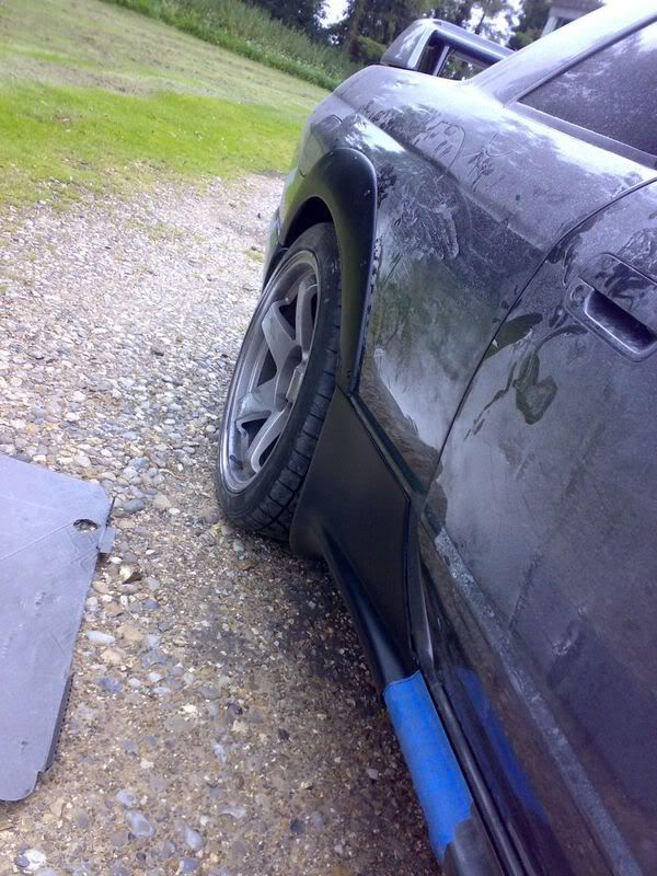

As for the arches I carried out some especially subtle work to my rear arches in Germany. In a car park at the Nurburgring, after a day of Gareth and I blasting around the track, I 'adjusted' the arches with a round steel fencepost. Needless to say this shattered the rusty steel original arches but provided loads of clearance
Thick layers of carpet tape provided a crude but protective edge and then I fitted bolt on JDM extensions when I got home

Stuart wrote:, I 'adjusted' the arches with a round steel fencepost. Needless to say this shattered the rusty steel original arches but provided loads of clearance![]()
Good luck buddy. Great to hear that your patience is paying off.
Good speedboating in that pic too

Stu, I know I've asked you this before but where did you get those arches from? GTR is going in for some work, one of the jobs being the rear arches. If it looks like it's going to cost a fortune to do new metal ones I may well just bolt some of these on. Although looks like you had aftermarket rear spat things behind the arches which blended the bolt ons in quite nicely?
- jap.slapper
- Posts: 985
Rear spats were Do-luck ones, and the arch extensions were cheapies from a guy on Retro-rides.
