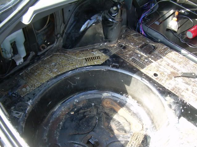

We're looking to fit a fuel swirl pot kit in the spare wheel well of the car. Just one slight problem it needs to be fire walled in. The fire wall what ever it is will need to be removable so when the car is on display at car shows I want the setup on show.
Any and all ideas welcomed as to how to do it. This is an old picture of the wheel well.
