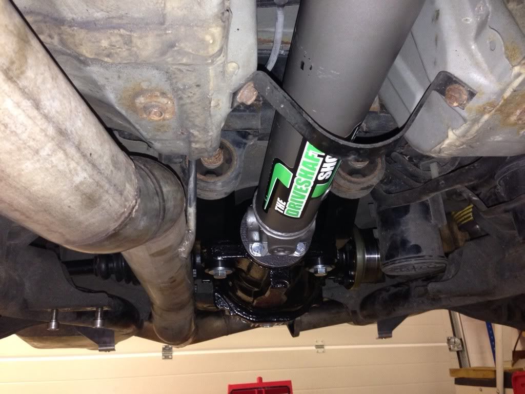

I've had to alter the exhaust yet again as the new drive shafts are much larger.

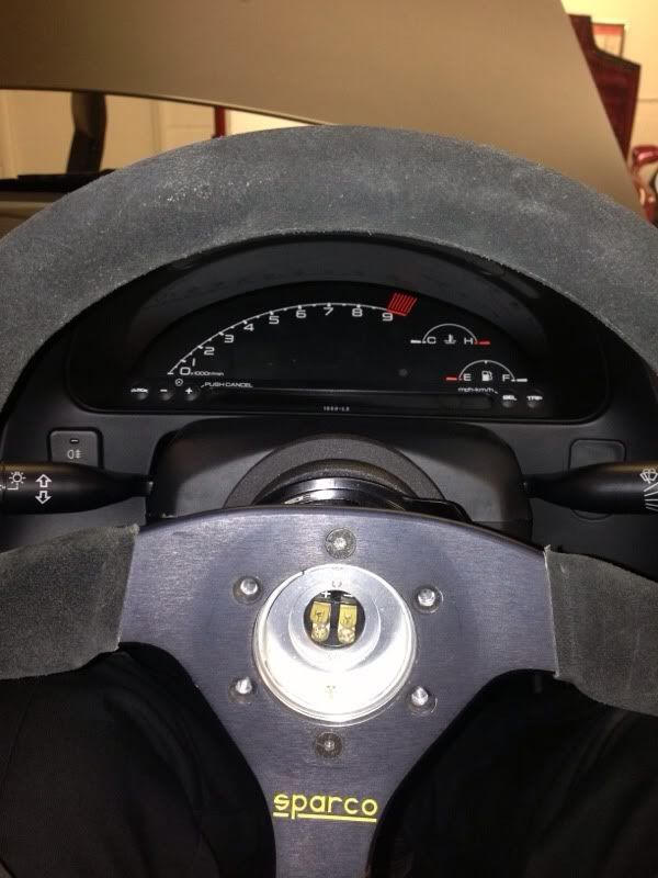

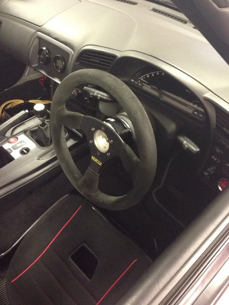

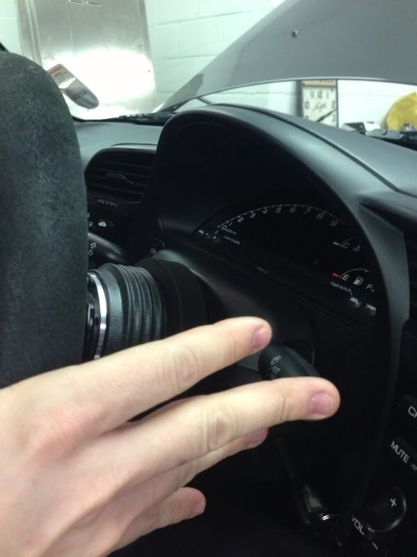

Got a new steering wheel and quick release to try
I like it as its much closer to me and my knees don't hit the steering wheel any more. One down side it's a stretch to the stalks. Luckily I have big hands and the fact I have a lot more space for my legs it's worth it
It is a 330mm wheel and you can still see the dash

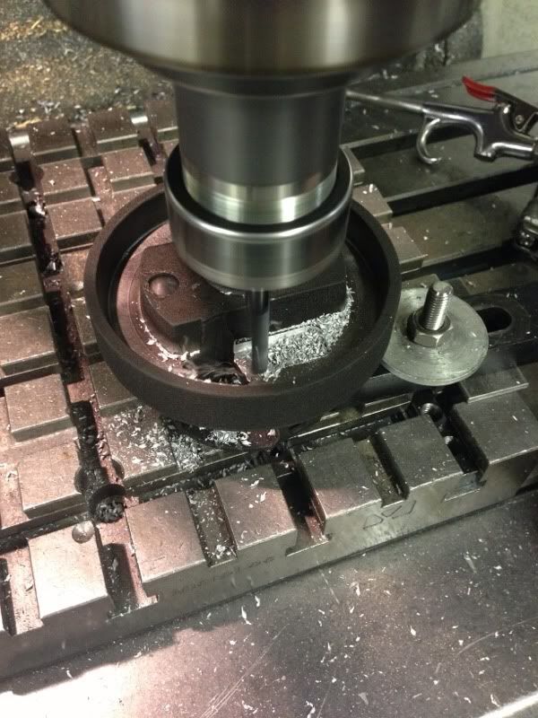

The momo boss was squashing my horn and airbag wires so had to quickly machine it the other day for clearance.

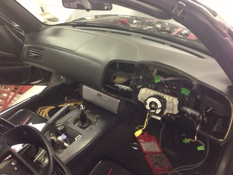

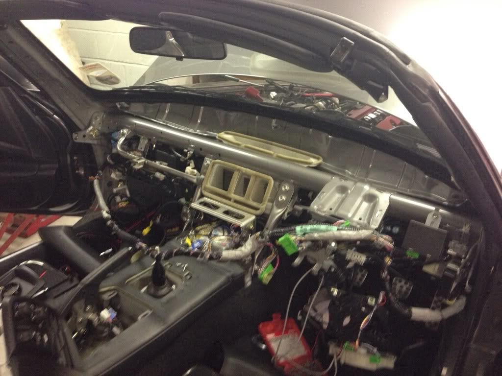

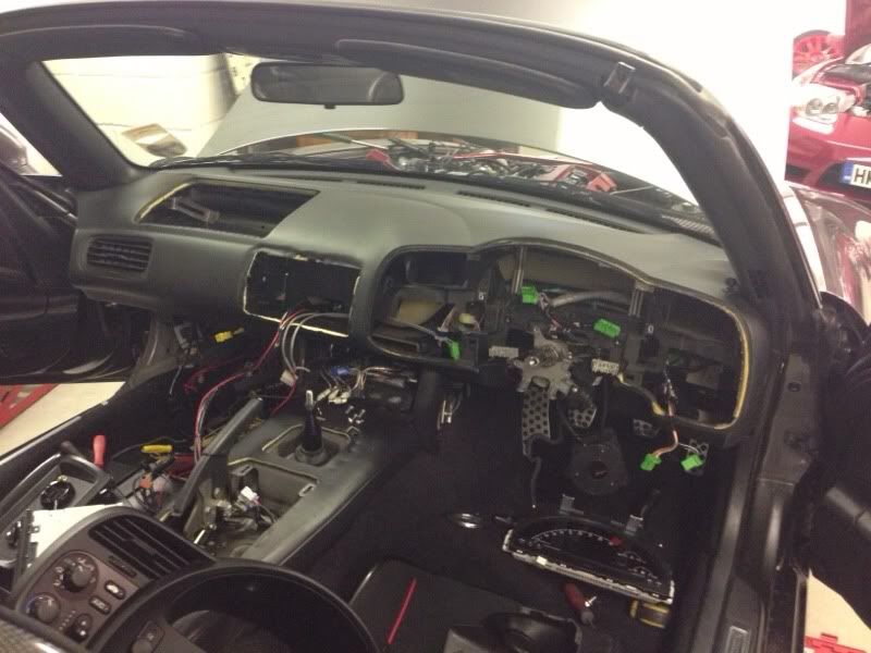

I pulled out my modified dash board this evening and put my original one back in to make a mount for the new dash. It's scary half way through.
Starting
Done and ready for some bracket making.

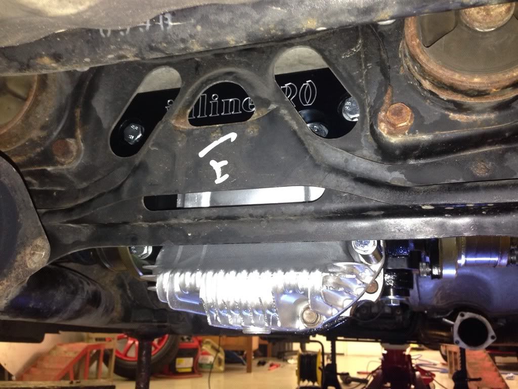

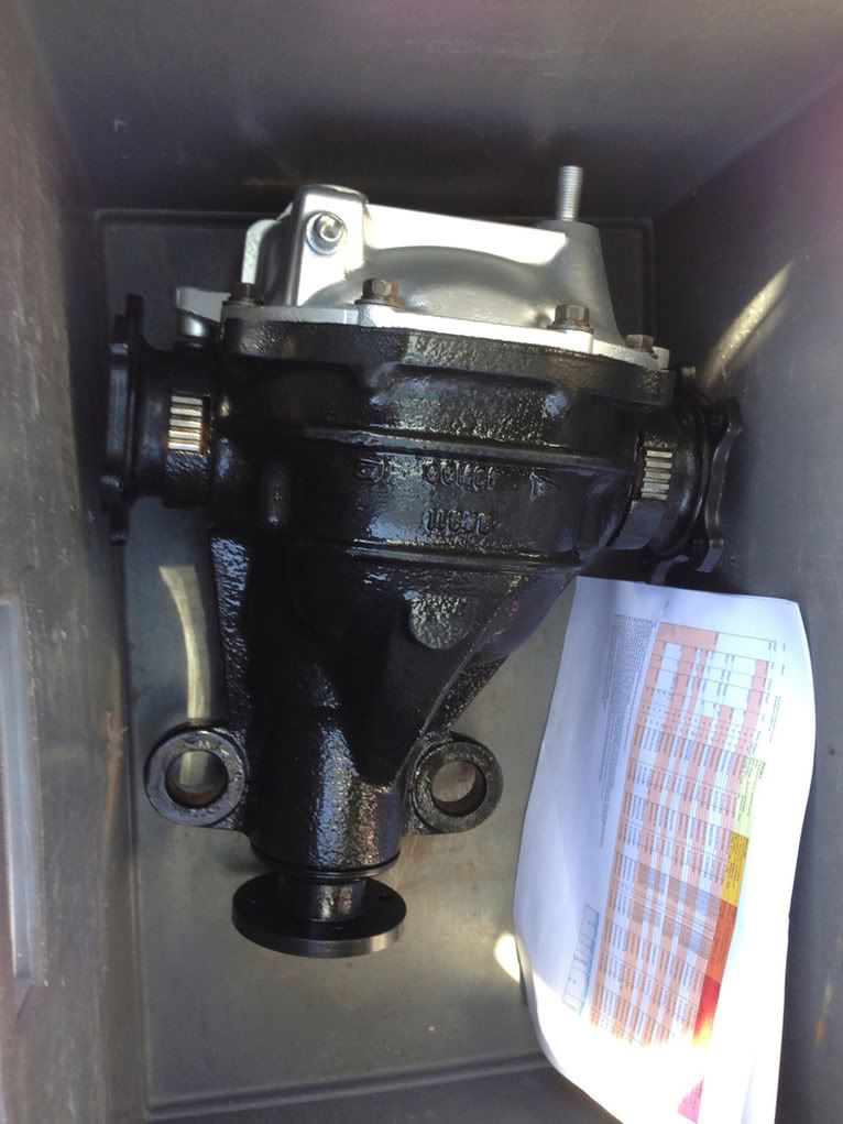

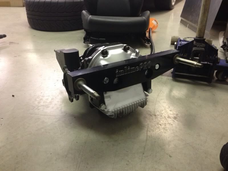

Some pics of the diff and drive shafts
Starting
