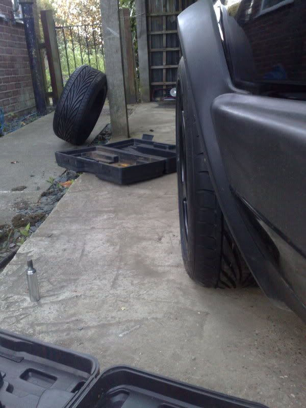

Most of my tools are still at the unit, so after emptying the Volvo for a jack and 17mm socket with a bar, I gave up and drove 11 miles round trip to the unit, got the tools and made my way back. Got the car in the air and took the front offside wheel off. Grabbed the Comp, lined it up and looked at the bore size versus the hub size...........
fuck!! Too big so I needed a spigot. Oh well, at least I'll sling a wheel on and see what it looks like.......
wrong fucking bolts too!! I needed flat faced ones and not the tapered versions I had.

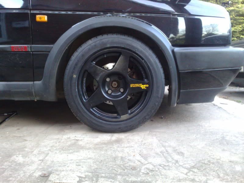

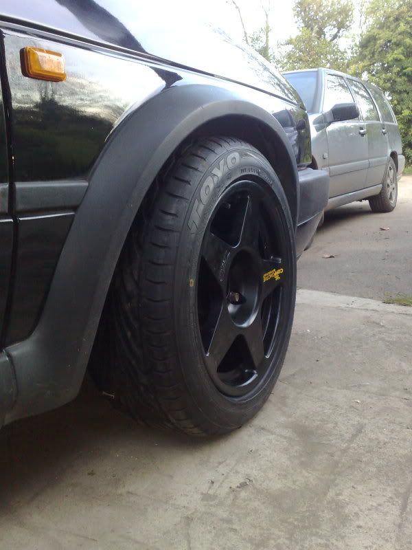

A mock up of what it will look like once I have removed the plastic arches, hammered and cut the steel arch and then replaced the plastic (Simple eh?
