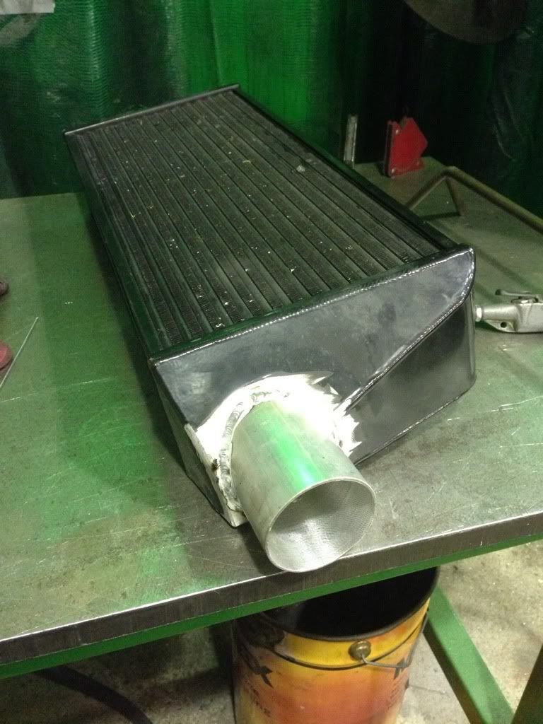

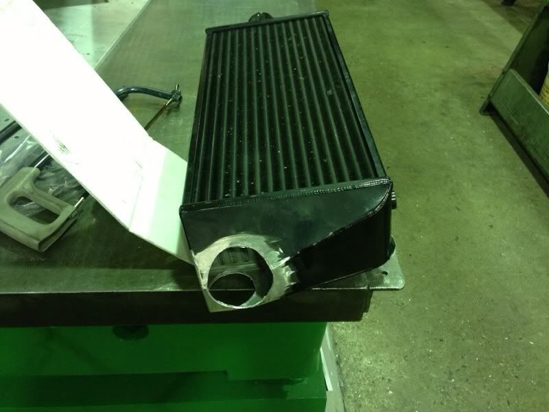

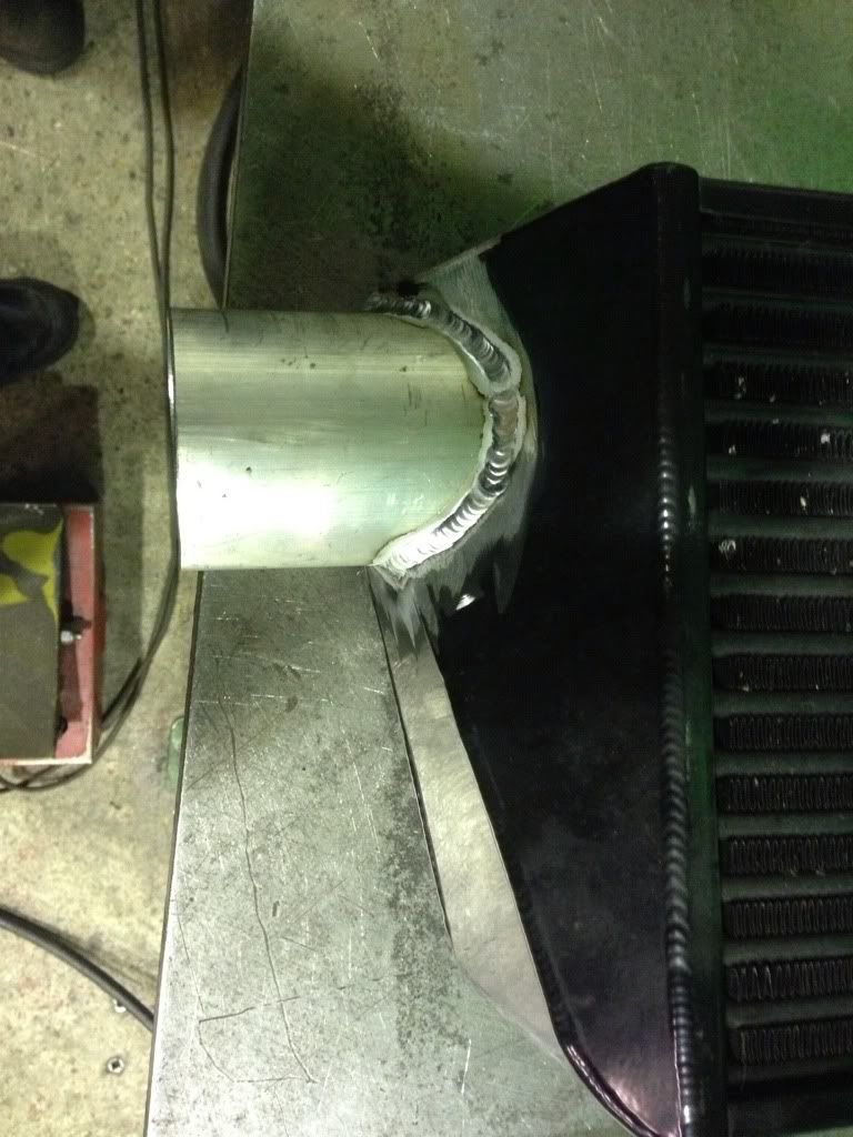

It's nice and long. Vtec comes in at 4k. Been doing some work today. Pulled the intercooler and modifying it. Will be all sorted by tomorrow so it can be re powder coated
Intercooler

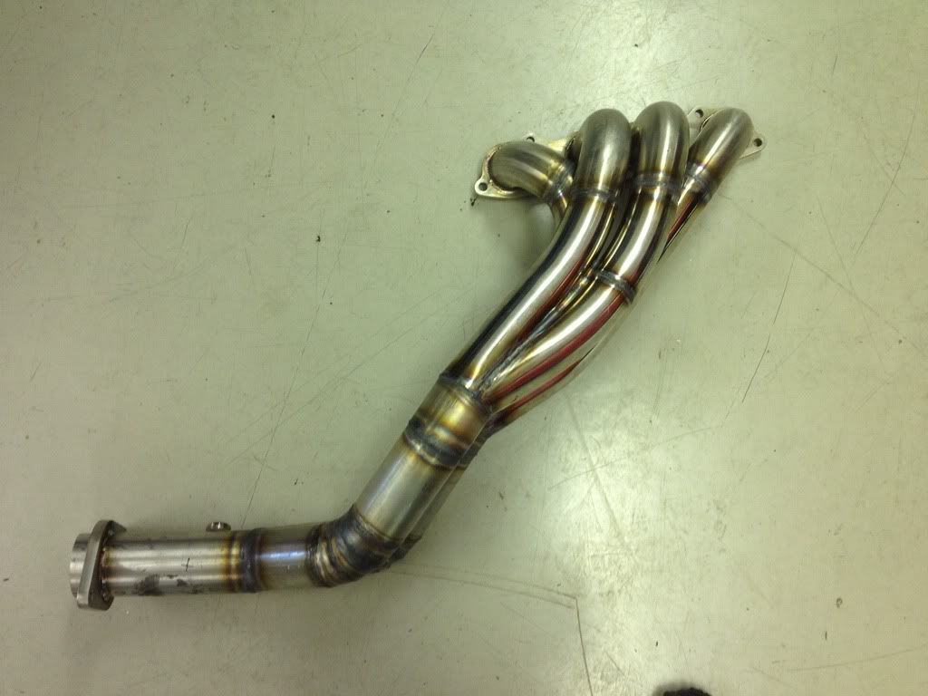

Oh made my own manifold in January but then altered the last section for the 3" exhaust in march. Just a little picture when it was almost finished. Pipe work size is 50mm-60mm-76mm. You couldn't buy one with those pipe sizes at the time but you can now. Quality of their one isn't the best I've been told. Mines out of 316 stainless.
