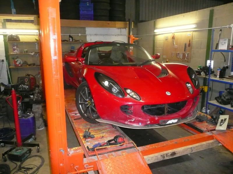

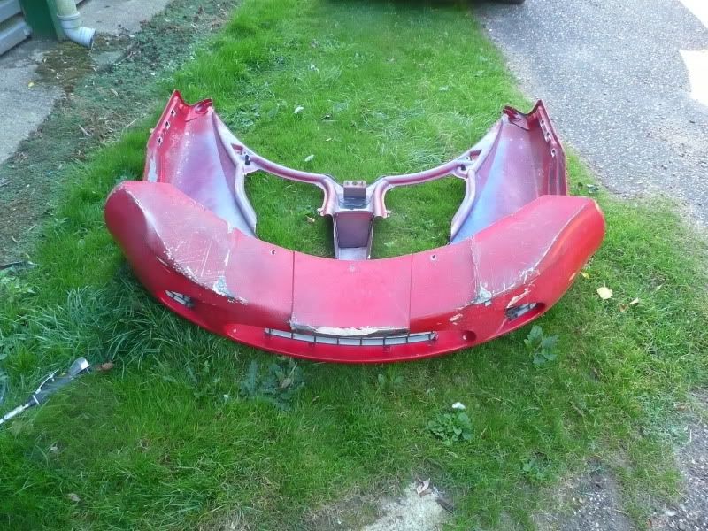

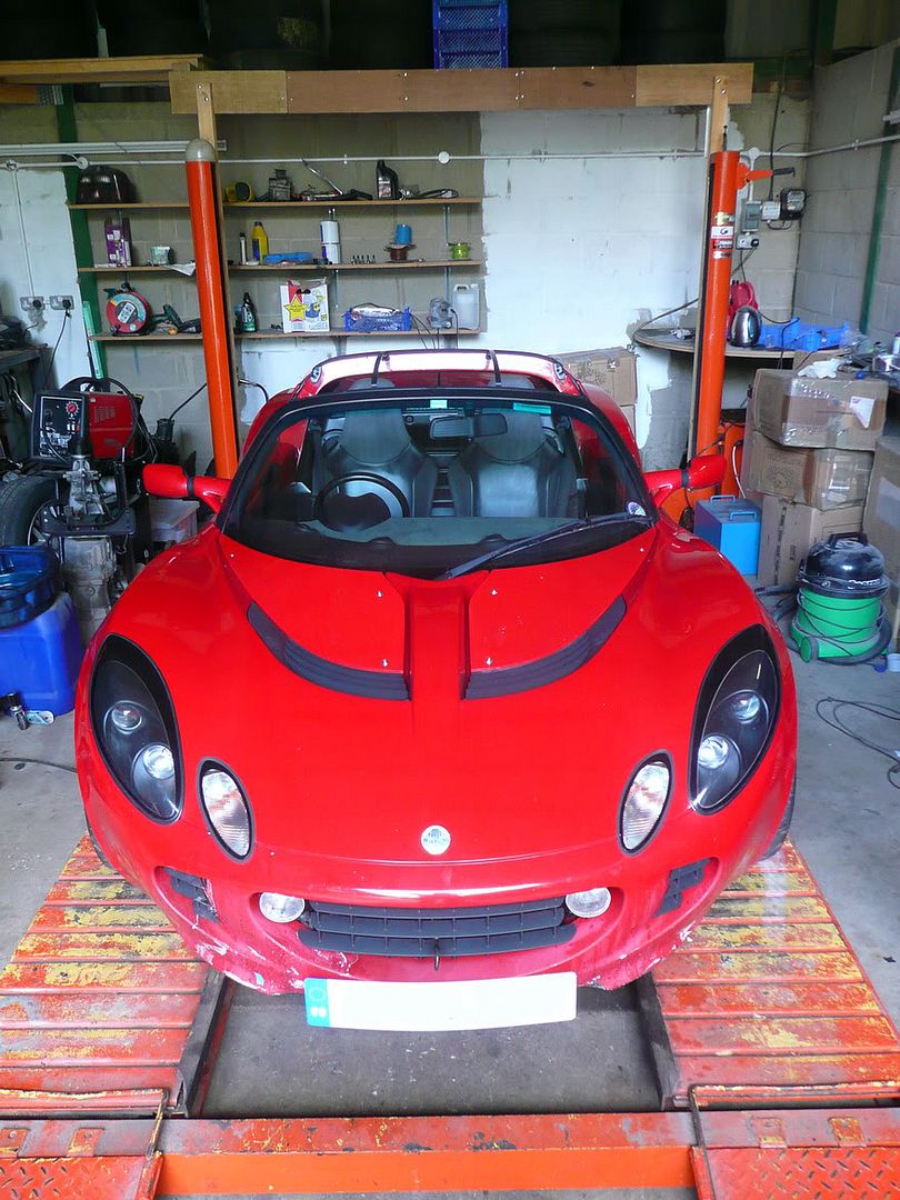

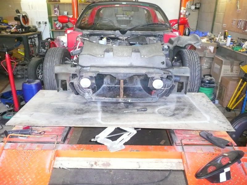

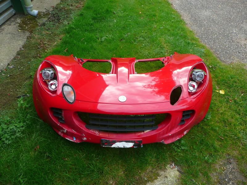

I know I said that this car would only ever be off the road for a weekend at a time, but I failed already. I underestimated how long it would take to fabroicate some front aero and modify the car to a quick release clam, so despite working every day since friday on it, it is still sitting on the ramp and the RX7 is outside. I will carry on working every night after work to get it back and running to get me to work on friday. However this is what I have been up to so far...

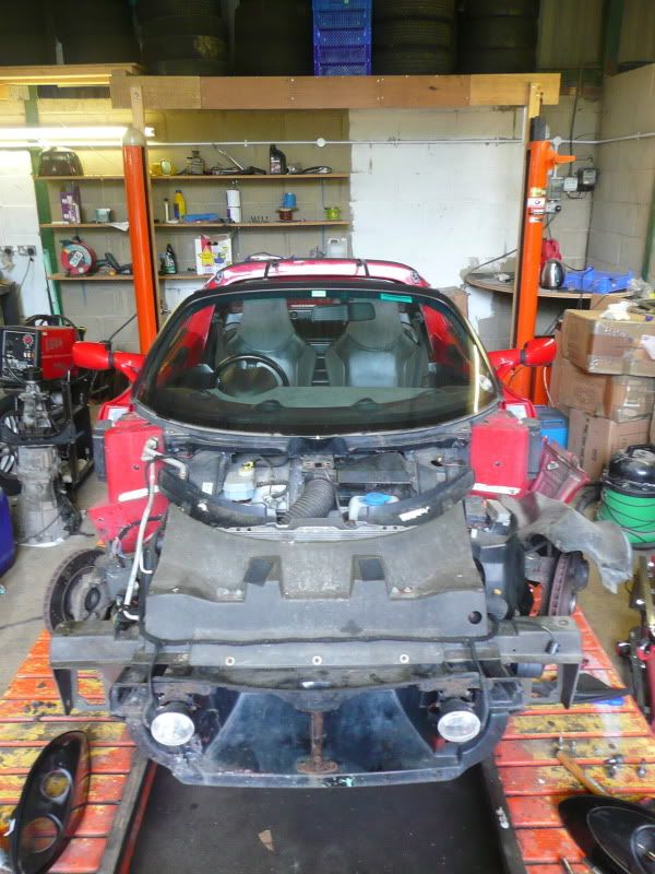

I started to remove the front clam, and pulling the car apart:

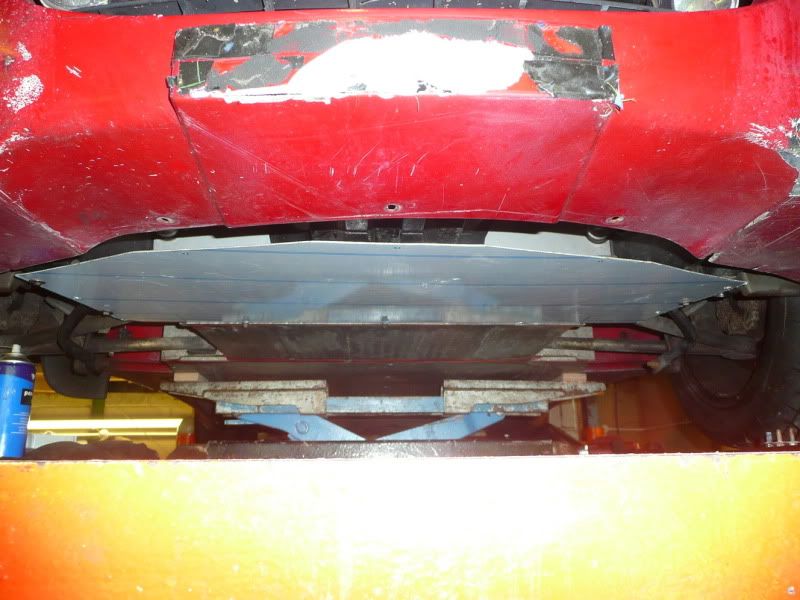

once it was naked I decided to also remake the front undertray to a completely flat panel, now that i was cutting the clam and it wouldnt need the form to mate up:

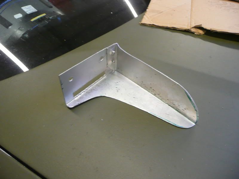

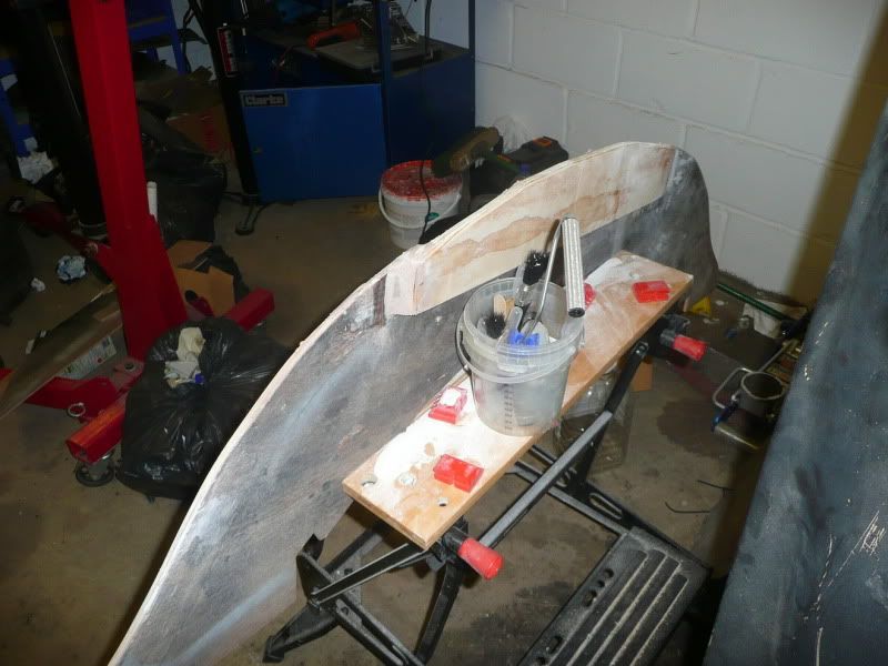

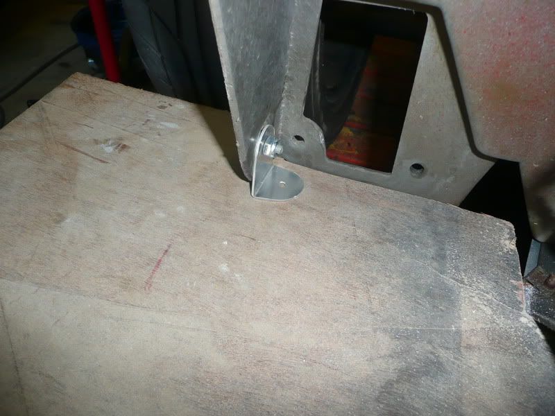

Then it was time to start on the front splitter which would be a substantial part of the new clam mounting structure. So a scrap of wood in the workshop was raised into place and I started making the brackets to bolt it up.

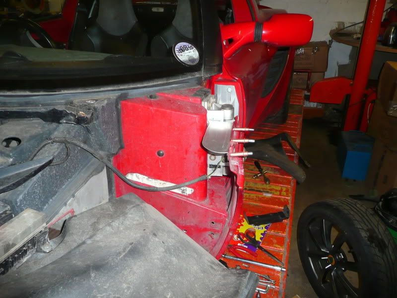

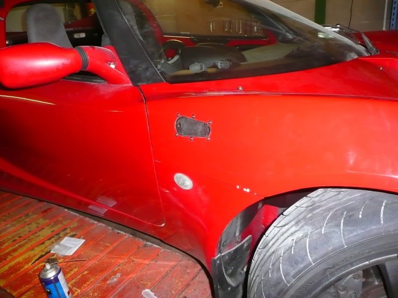

I also made brackets from alluminium mounting to the door hinges ( alluminium extrusions) to fix the lower A-panels, and take the brackets for AeroCatches to fix the back of the clam. All the bits they joined to needed a bit of modification taking yet more time.
The clam was the trimmed down to sit flush and at the original height. ( this required a lot of fitting and re-fitting to get right, but it got there). I then added 50mm to give a sensible splitter size but still offer plenty of downforce.
I then cut the aerocatch holes and machined away the back of the clam reinfocement to allow them to be flush fitting from the back. by this time the driving lamps had been damaged as they are in teh way for taking the clam on and off so i decided to bin them and save weight. I will replace them with an HID converstion to the main lamps instead.
It was temptomg to turn it into a front diffuser but that would have offer naff all gain at road heights so decided it wasnt worth the effort, and I know I am not going to get the car down to 50mm or so ride heights where it starts working. that was about where the weekend ended late sunday night. The splitter was just a lump of old ply, and the clam wasnt attached at the front at all and there rear wasnt lined up. Tonight i went straight there after work and complted the wooden mock up of the diffuser adding some extra features:
the mouth will direct a little more air underneath and accelerate it further for even lower pressure, whilst the strakes are there to stiffen, guide air underneath and also give me something to ground out on without wearing the main body of it.
Tomorrow night I will start repairing the orriginal clam damage, laying up the carbon fibre and hopefully get the splitter finihsed soon. There are still teh clam front mounts to worry about.

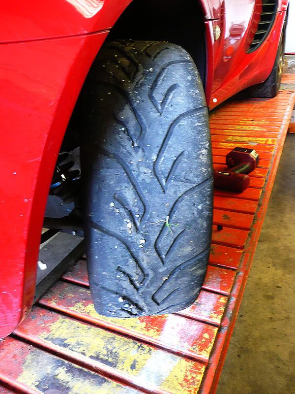

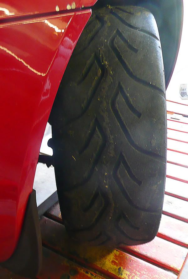

I forget to add that I had some interesting tyre rubber build up at snetterton. I will try to get the car on a Hunter on friday aswell to check geometry, but maybe it is just because i was staying out for quite long stints and overheating them too? Here are more pictures to show what happened:
strange wiggly line just off centre about 5mm high. The pictures were taken after driving 10miles back to the workshop so they had worn down a fair bit by then.

Tyres and that style of wear may be due to over inflation once hot, my theory being that the rubber gets scrubbed off of the shoulders of the tyres under cornering and then into the middle of the tyre. (over inflated road tyres always wear more on the middle strip?) May be complete bunkum but what were your tyre pressures when hot after the long sessions you were taking?
As for the old scrap of ply
(You can tell what's coming can't you) can you replace that when you get a chance as that had loosely been ear marked for use on Betty.
