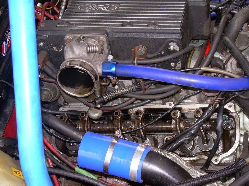

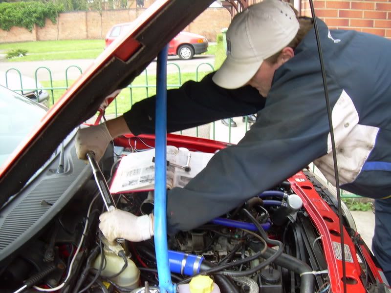

Another interesting day spent with the car. The aim for today was to re-torque the heads with a higher setting.
As we were putting it back together Al noticed that one of the rockers was seriously cracked
We did have a couple of spares so this was changed.
