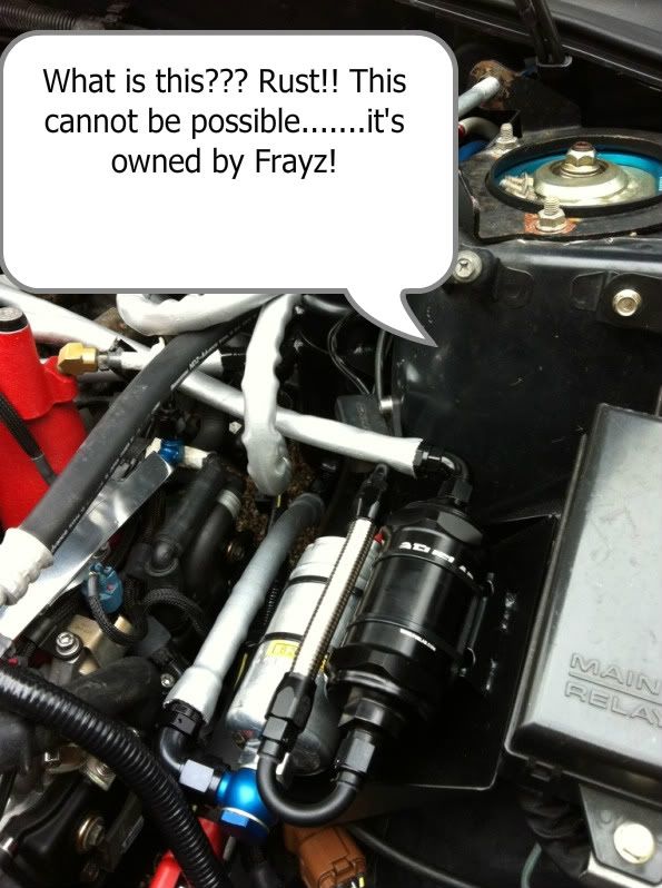

Lol, thats stuff still to go for powdercoat yet Stu.
Haha, youre not the first to point it out :)

bravo, this is just such awesome work mate :) the attention to detail! (minus that rust ;) ) is just topshelf. awesome :)

It's far from clean Chubs! Bleedin rotten and needs a damn good jolly up. Get on over then ya tyrekicker! :P
